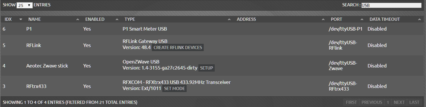

Recently I bought a Z-Stick from Aeotec, but when I add this to my Raspberry, besides my RFLink it kicks out the RFLink. So it looks like I have to choose between RFLink of the Z-Stick. Does anybody knows if it is possible to run both systems on the same Raspberry with Domoticz?
Re: Z-Stick and RFLink
Emjay wrote: Monday 10 September 2018 18:29 Recently I bought a Z-Stick from Aeotec, but when I add this to my Raspberry, besides my RFLink it kicks out the RFLink. So it looks like I have to choose between RFLink of the Z-Stick. Does anybody knows if it is possible to run both systems on the same Raspberry with Domoticz?
Yes is possible:
domoticz hardware USB connected .png (116.02 KiB) Viewed 493 times

You should use/read our persistent devices wiki, or updated to the latest beta version, here you will see new serial names with id's that stay the same
