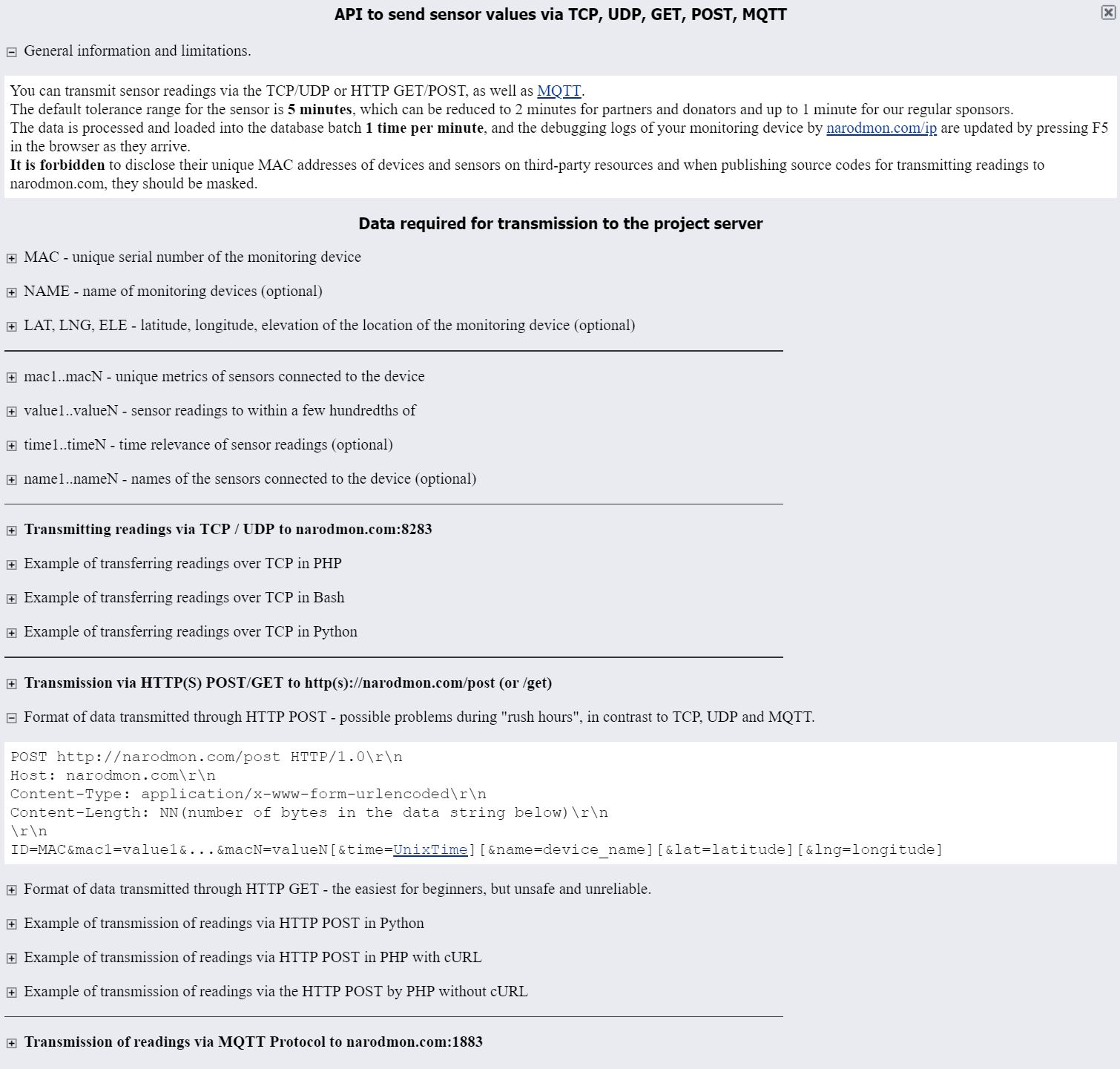

Hello everyone and I am asking for help.
I have been struggling with this for a long time.
I would love to send readings from the sensors to the narodmon.ru website
I managed to send something with Easyesp but I'm not here.
I am asking for a script that will send several readings from the sensors.
Example of Phyton codes from the site. Most descriptions are on the site. Maybe it's easier to write code in LUA or dzVents?
I'm giving up !!! :( :x
And I'm sorry for my English. Google translator helped me.
