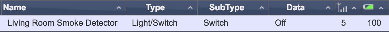

I have one of these which I am happy with, it's Zigbee, I use a CC2531 with Zigbee2MQTT to communicate with it.
I'm also getting Battery level and Signal info into Domoticz.
Screen Shot 2018-08-25 at 7.05.53 pm.png (39.35 KiB) Viewed 3565 times
I've not had any false alarms so far and I've tested that it works by smoking a cigaret. 8-)
