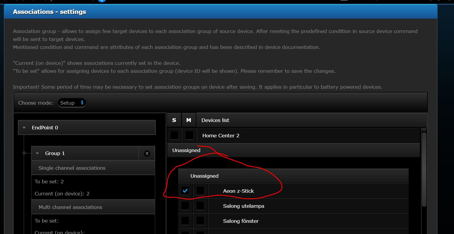

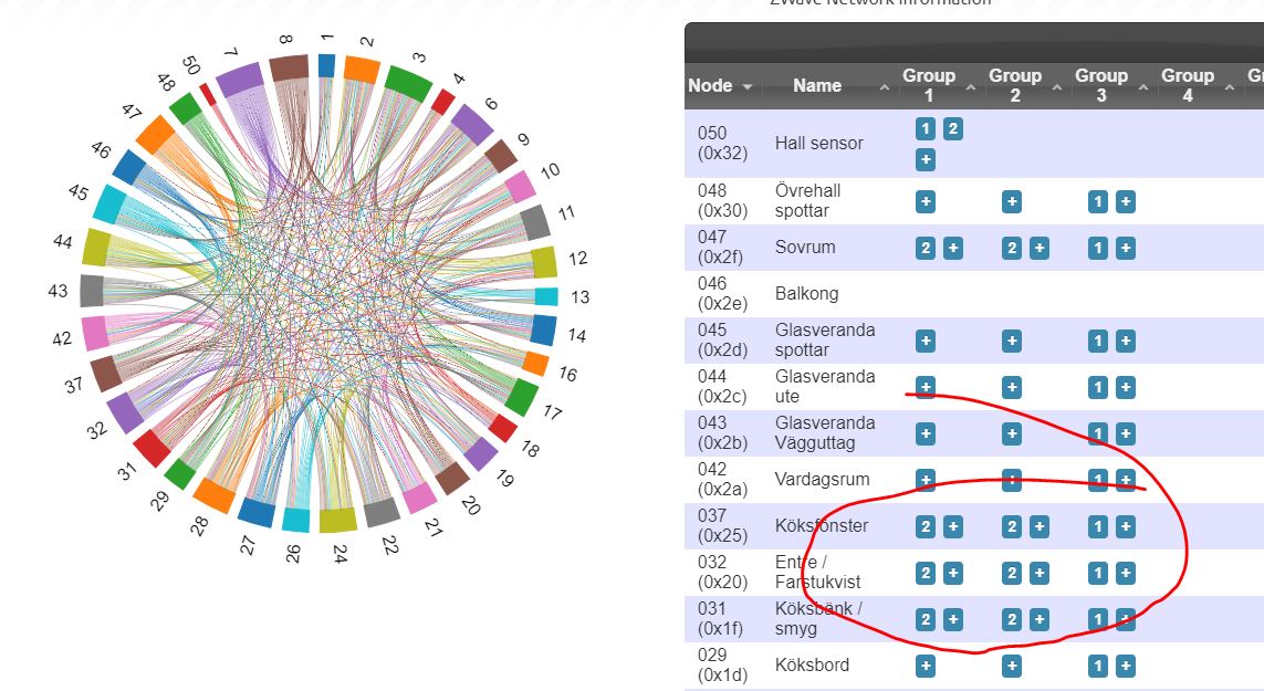

I use Fibaro HCL as primary controller and Domoticz as secondary. Long time ago this worked as a charm and Domoticz got the node updates if the associations were done correctly. Then I have been using only Domotics for some month and used a second Domoticz as secondary.
I then encountered node update issues between the two Domotics so I decided to change back to the Fibaro HCL as main but I have still the same problem, the secondary controller (Domoticz) won't get the node updates.
I'm pretty sure that I done it correctly in fibaro but what is I missing? In Domoticz it looks ok but no update received.
