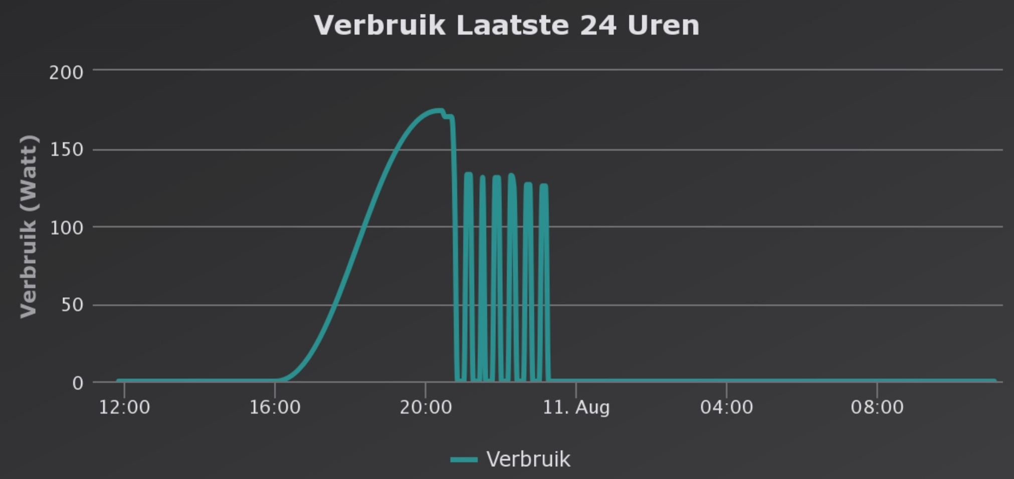

I have several Fibaro switches, dimmers an rollerswithces in use. One of the dimmers (type 2) is having problems.
Setup: no conventional switches attached, just one 150W halogen lightbulb. Calibrated the dimmer several times.
After calibrating, parameter 2 reads 79%.
Whenever I switch on the light, after approx. 10 minutes, the light switches off. After another 10 min back on and so forth (see attachment).
The dealer suggested lowering the value of parameter 2 to 50% to see if it has any effect.
Nothing changes, just the period increases from 10 to roughly 15min.
Does anyone have any ideas? The Fibaro manufacturer does not respond to my questions.. :x
