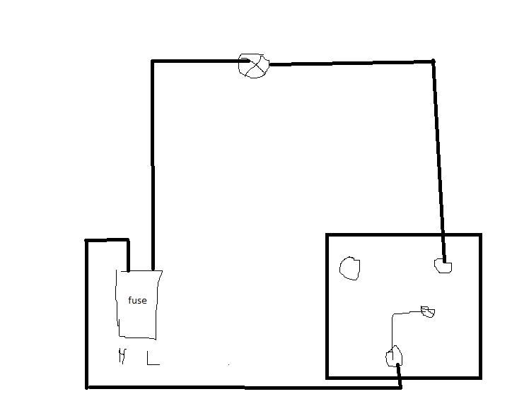

ok i just made a small drawing.
My electricity skills are basic so i wane asked here
In the red square i the place i need to put my sonoff.
So any help how to wire the (wissel) switch to a single switch.
My thoughts are in marked in brown
Any suggestions are welcome.
No i need to buy some sonoff's to test(or if somebody have some seconds hands :-) ))

So if I am reading this correctly your switch wire is white (I use black). One of the white wires is going to be the L(ive) wire (and connected to the blue wire) and the second one will be switch wire (continuing in Grey). Your neutral line is red, and is this in your wall socket where the sonoff should go?
So the second switch won't be used at all.
Then you are good to go!
In the Netherlands:
Brown is live wire
Blue is the neutral
Black is the switch wire
Green/Yellow is the earth/ground wire
Above does not apply on older homes ;)
But rewiring is indeed no option, to labor intensive and probably to expansive.

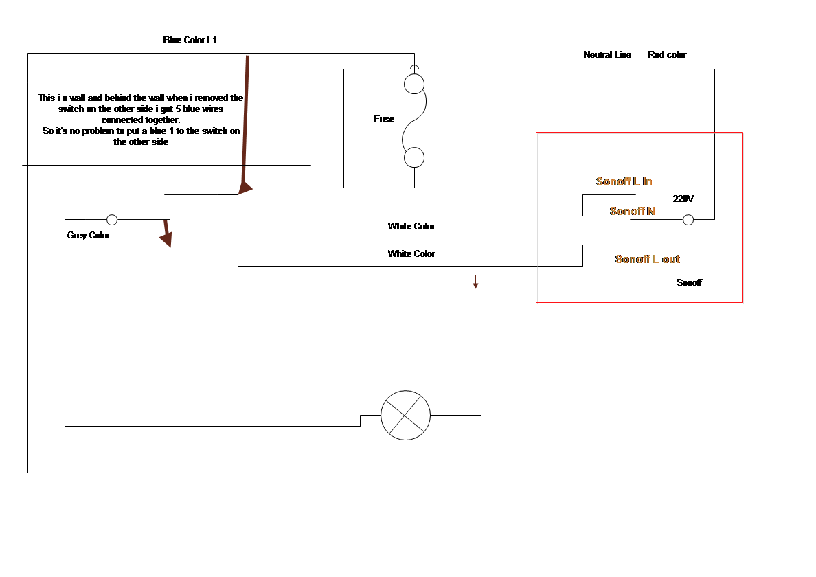

hmm have taking al my guts with me an put new wire's in 1 switch.
So far so good but is still missed something.
My setup in a normal situation is like this.
The problem is that they not switch on the Life line but on the Neutral in my situation
So my life line goes to the bulb and my neutral to the switch.
So how do i need to connect the sonoff in this situation?
Do i only need to connect my N to the Sonoff N en just a black 1 in the Lout ?
