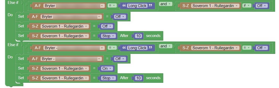

I have a blockly that opens blinds if closed and close them if open. How can I have the same switch stop the blinds going up/down if pressed within 10 seconds after open/close?

You can do that by repeating the command (works with most blinds, I am not 100% if it works with all of them)
Anyways, this how you can do that:

Huh? I think you misunderstood but I tried anyways without success:
That's what you meant?

My blinds stop if you send the command a second time. The stop command does not work in my case.
So I send "close" and 10 seconds later I send another "close".
But as I said, maybe not all blinds controllers work like that.

I see. No, I have to send the Stop command for it to stop.

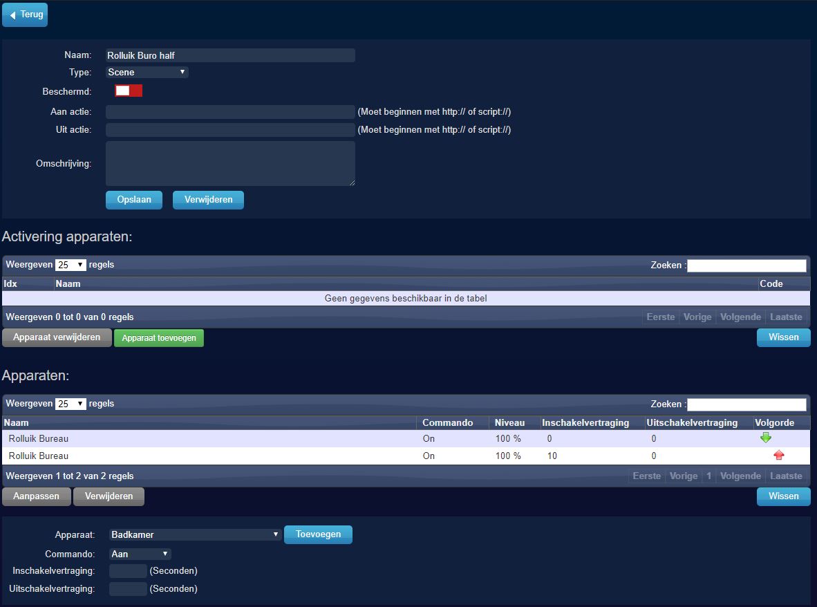

Make a scene that you can use in your blockly.
Example:
