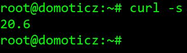

JSON is a format that you need to learn how to navigate. For example this linux bash command gets only the temperature.
Make sure you have jq installed: apt-get install jq
curl -s 'http://username:password@ipaddress/json.htm?type=devices&rid=778' | jq .result[0].Data | sed 's/\"//g' | awk '{ print $1 }
The above in my case displays only the temperature number: 20.6 in the terminal.

kimhav wrote: Monday 06 August 2018 18:37 Thank you, I'll continue with the above to pick out what I need; that really helps out.
Note that the raw output from the JSON was:
"20.6 C"
This removes the quotes: | sed 's/\"//g'
This part on the end displays only the first part of the string: | awk '{ print $1 }'
Get's 20.6
If you only wanted to get C and not the number you would use | awk '{ print $2 }'
