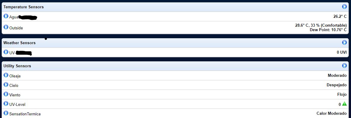

This script looks up some meteo data for beaches in Spain from the national weather office AEMET.
Aemet is a bit funny about their API. You have to access it using one URL in order to get another URL where the data is found. Most of the time (I think always) that second URL is the same, but you need to access it in order to 'activate' the data.
Second thing is: they have their headers wrong, instead as reporting as JSON the header says text/plain.
For that reason we need to user the dzvents Util fromJSON.

		timer = { 'at *:43', 'at *:24' },
		httpResponses = { 'aemeturl', 'aemetInfo' } -- matches callback string below
        data = {
            alink = { initial = 0 }
	execute = function(domoticz, triggerItem)
	local miplaya = 'xxxxxx'
	local miApi = 'YOURAPIKEY'
	local posti = domoticz.devices('AguaPostiguet')		-- Sensor for the water temperature. Virtual temperature sensor
	local prevposti = tonumber(posti.temperature)
	local waves = domoticz.devices('Oleaje')			--wave sensor (intensity of the waves). text sensor
	local prevwaves = tostring(waves.text)
	local Cielo = domoticz.devices('Cielo')				--cloud sensor (percentage), descriptive. Virtual text sensor
	local prevCielo = tostring(Cielo.text)
	local viento = domoticz.devices('Viento')			--Wind description. text sensor
	local prevviento = tostring(viento.text)
	local sTermica = domoticz.devices('SensationTermica') -- Feel temperature descripcion. text sensor
	local prevsTermica = tostring(sTermica.text)
		if (triggerItem.isTimer) then
    local geturl = 'https://opendata.aemet.es/opendata/api/prediccion/especifica/playa/'..miplaya..'/?api_key='..miApi..'&'
			domoticz.openURL({
				url = geturl,
				method = 'GET',
				callback = 'aemeturl'
		elseif (triggerItem.isHTTPResponse) and (triggerItem.callback == 'aemeturl') then --fetching the link
			local response = triggerItem
			local json = domoticz.utils.fromJSON(response.data)
			if (response.ok) then
			 local Aemetlink = tostring(json.datos)
				domoticz.openURL({
				url = Aemetlink,
				method = 'GET',
				callback = 'aemetInfo'
				print('**aemeturl failed to fetch info')
		elseif (triggerItem.isHTTPResponse) and (triggerItem.callback == 'aemetInfo') then --check aquired link and get data
			local tagua = domoticz.utils.round((tonumber(json[1].prediccion.dia[1].tagua.valor1)),1) --getting the temperature of the water
			    if tagua ~= nil and prevposti ~= tagua then --we will only update the sensor if a valid number is returned AND it is not the same as the previous value
    			posti.updateTemperature(tagua)
			local wave = tostring(json[1].prediccion.dia[1].oleaje.descripcion2) --getting the state of the waves
			 wave = tostring(wave):gsub("?","é")
			  wave = string.gsub(" "..wave, "%W%l", string.upper):sub(2) --filter out 'funny' characters and capitalize the string
			    if wave ~= nil and prevwaves ~= wave then
    			waves.updateText(wave)
			local estadoCielo = tostring(json[1].prediccion.dia[1].estadoCielo.descripcion1) --getting the state of the sky
			 estadoCielo = string.gsub(" "..estadoCielo, "%W%l", string.upper):sub(2)
			    if estadoCielo ~= nil and prevCielo ~= estadoCielo then
    			Cielo.updateText(estadoCielo)
			local termica = tostring(json[1].prediccion.dia[1].stermica.descripcion1) ----getting the feel temperature
			 local termica = string.gsub(" "..termica, "%W%l", string.upper):sub(2)
			    if termica ~= nil and prevsTermica ~= termica then
    			sTermica.updateText(termica)
			local vient = tostring(json[1].prediccion.dia[1].viento.descripcion1) -- --getting the state of the wind
			 vient = string.gsub(" "..vient, "%W%l", string.upper):sub(2)
			    if vient ~= nil and prevviento ~= vient then
    			viento.updateText(vient)
			print('**aemetinfo failed to fetch info')
