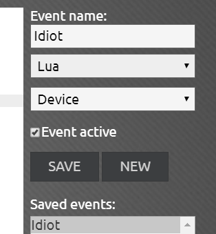

I am by no means a domoticz LUA expert but I played a little bit with your second script and it looks like you did not save it as a device type script.
Like

waaren wrote: Saturday 28 July 2018 0:10 I am by no means a domoticz LUA expert but I played a little bit with your seconds script and it looks like you did not save it as a device type script.
Like
Thanks, your better then me lol
But why aren't my main script working.
Its saved as device. I'm going to try and save it as a .lua file tomorrow. See if that's working better.
