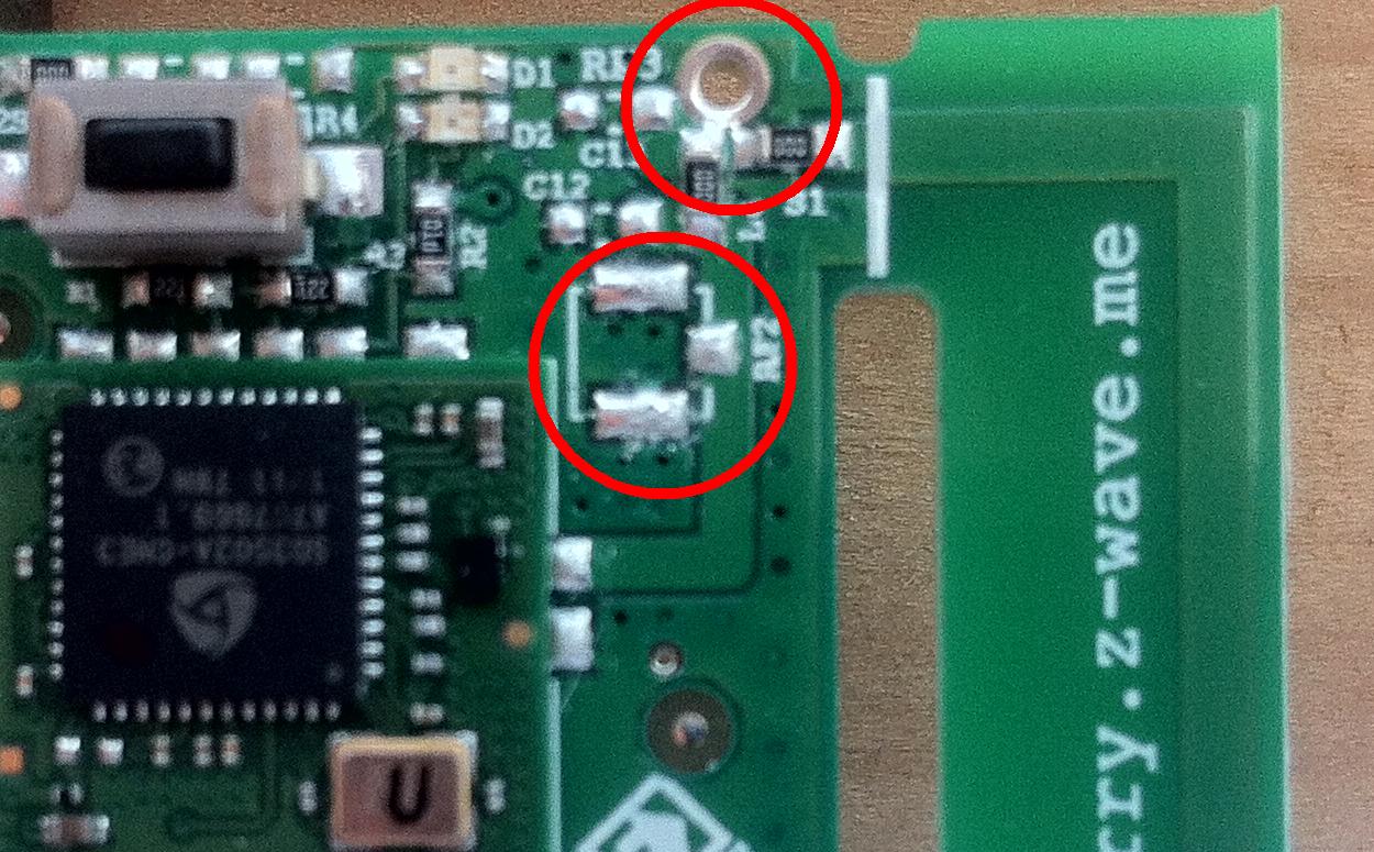

From what I can make out, the Razberry boards work better with an external antenna. The internal one can pick up rfi from the pi board itself. I would try a Z-Stick, preferably connected with a USB extension to get it away from the pi itself.
I have a Razberry that I intend to use as a second controller, but have already bought the external antenna and cable assy.

@fargle Do you think it would work to add a gpio-cable to move the razberry board from the raspberry pi ?

An I/O cable may be worth a shot, it certainly cant hurt, 30cm is about the max length I would try.
Alternatively there are places on the Razberry with provision for soldering either a mini coax connector (not easy) or an antenna coax cable (a bit easier)
The light on the razberry flashes when the RPi starts but Domoticz can't find it. I can see the device if I do ls /dev/tty*
The cable is 19 cm
It get extremely hot as well.
I have the older model of the razberry with out the extended antenna.

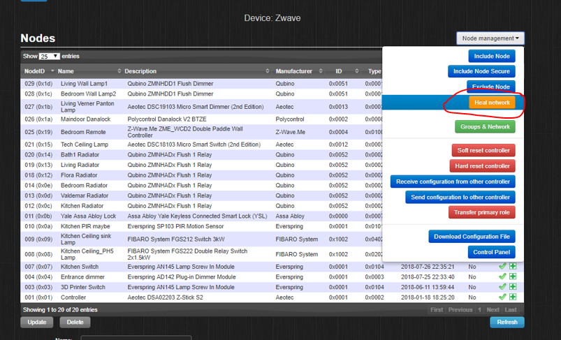

It seems that the device number 8 (green colour) isn't connected to anything. Have this device been included properly to/with the controller?
The ESXI number 13 (red colour) is forwarding to TVrum device number 6 (orange colour), then device 6 is then connected to your controller.
I would try to ensure that the green 8 and then afterwards try to heal network

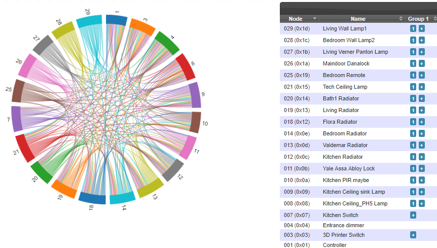

Ok, I thought it was the wheel showed the groups

Your setup is still not ok, I think it's symptom that device 8 works and 18 fails. The round wheel with colours shows that your devices are not connected as they are supposed
Look at my wheel - yes I have more device, but your setup should have similar "connections" to each other, and they don't
Did you try to "heal" network?
Maybe you need to explain in details each device; number x: manufacture model
My wheel:

bjacobse wrote: Friday 27 July 2018 12:47 try to heal network, be patient and wait some time, not sure how long maybe 30min or less
This my list, I have run a heal network several times, I have set it to heal each night as well but still node 018 fail
2018-07-27 13:51:40.025 Detail, Node018, Polling: COMMAND_CLASS_SWITCH_BINARY index = 0 instance = 1 (poll queue has 0 messages)
2018-07-27 13:51:40.025 Detail, Node018, Queuing (Poll) SwitchBinaryCmd_Get (Node=18): 0x01, 0x09, 0x00, 0x13, 0x12, 0x02, 0x25, 0x02, 0x25, 0x4d, 0xba
2018-07-27 13:51:40.027 Error, Node018, ERROR: Dropping command because node is presumed dead
