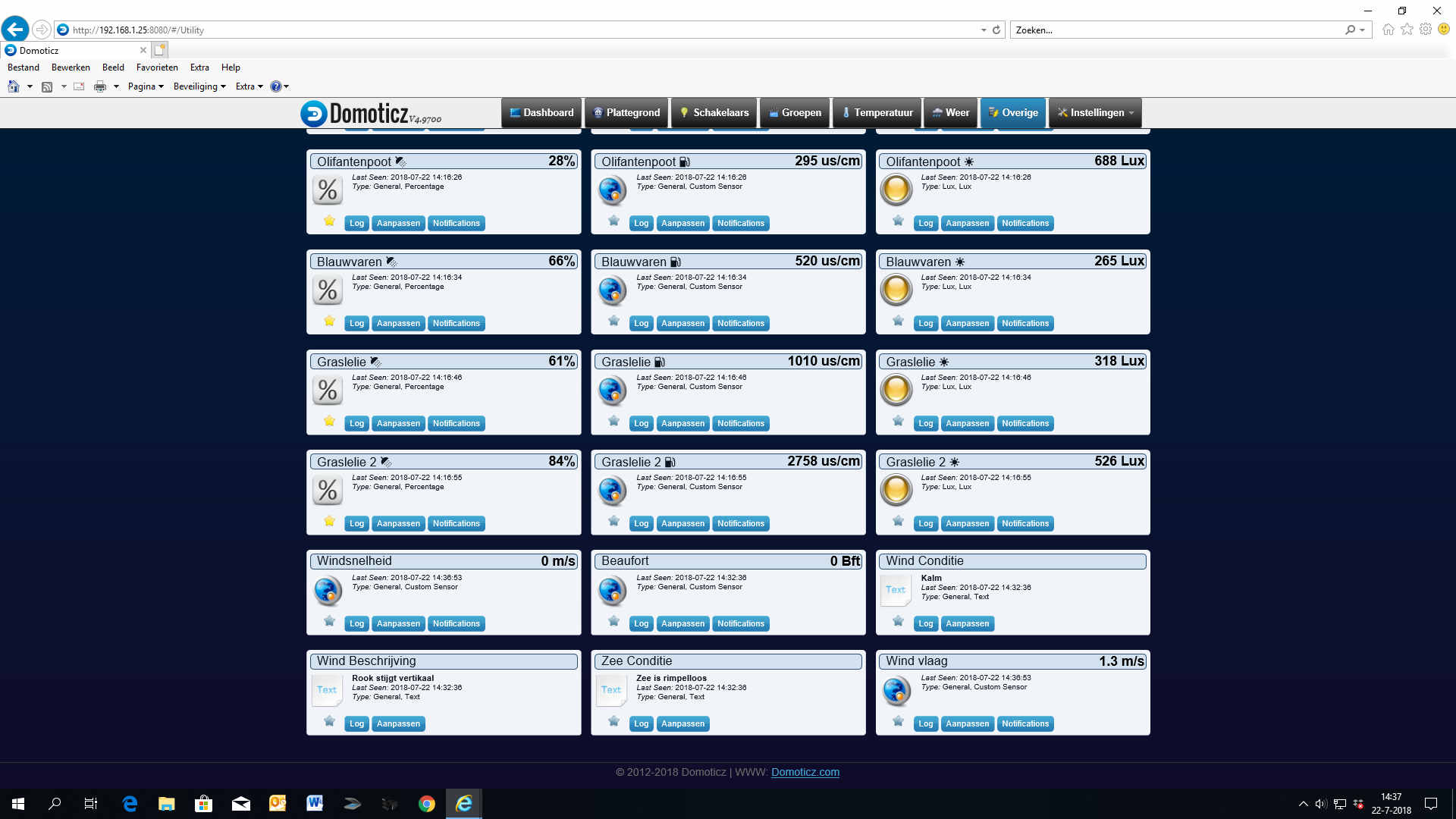

wind gust.jpg (207.08 KiB) Viewed 1890 times
Wind Speed and calculeted Wind Gust.
