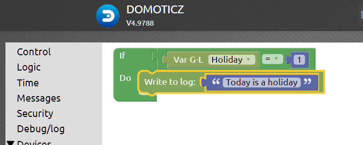

This leads to my next question, how can I use this in a blockly scripts? I thought that Holiday would be a boolean, either true or false,

bjacobse wrote: Friday 20 July 2018 19:22 ... how can I use this in a blockly scripts? I thought that Holiday would be a boolean, either true or false,
domoticz does not support boolean type user variables but you can simulate this by defining one as an integer and set it to 1 (true) if it is a holiday and to 0 (false) otherwise.

Thank you again Waaren,
I thought this wasn't possible as the Holiday variable is a string and the only way was to string compare the content, so I'm glad your example shows how easy it is
