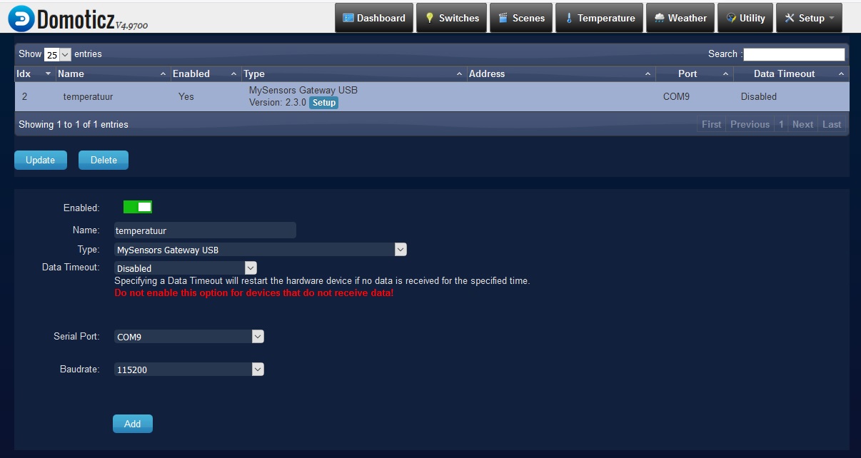

That MySensors triggered me! Thanks!
Now I've got an Arduino Uno running directly trough USB.
I've disabled the radio in the MySensors code and the serial
output is enabled so the gateway runs over USB comport now.
On the Arduino uno runs a piece of code for the temperature sensor also...
All wires now, directly on USB! And Domoticz likes it! 8-)
