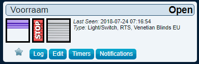

If you have an RFLINK with the right frequency for Somfy it's easy, at least it works for me.
Change Switch type of the device that is found by 'Accept new Hardware Devices' with the Edit button to Venetian Blinds EU.

EddyG wrote: Tuesday 24 July 2018 13:30 If you have an RFLINK with the right frequency for Somfy it's easy, at least it works for me.

Yes, that's all. If you act as the pages describe you can send your own unique codes, like I did with my RFXCOM hardware.
That worked for me, don know how.
Those RTS commands are not saved in the Domoticz database, so I think that RFLink saved those values.

EddyG
Posts: 1042
Re: how can i add Somfy blinds to Domoticz ? (i have de 433.92)
Post by EddyG »
DO NOT DO THIS!!!
I found out the hard way that this is not the right procudure!!!
If you use a remote controler like the Telis together with these created devices in Domoticz, you are proberly going out of sync with the 'Rolling Code'
At the end both (domoticz and Telis) do not work any more.
I had to reset the somfy motors and setup Domoticz and my remotes again.
