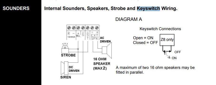

Based on my own experience, I assume you have to use a relay. The Raspberry GPIO is going to be used to control the relay and the relay output (N-NC) are connected to your alarm (two pins on your alarm pin connector).
IntelliSense800 keyswitch wiring.JPG (43.57 KiB) Viewed 1029 times

so I've found this, and imagine just connecting a two core cable from one of the relays, into Zone 8 of the alarm. Based on the documentation of the alarm above, what connections are needed, and would the power issue I mentioned be a concern?

Sorry, I'v just realised it was you who posted the alarm documentation, and mentioned N-NC - would that be common and normally closed?
