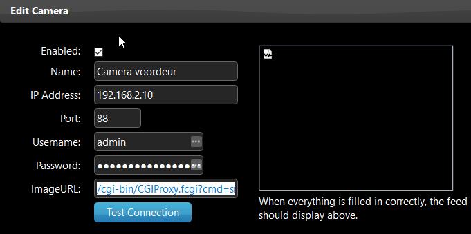

i have a Foscam C1 but i cant get it working in Domoticz, i found only one topic about it in this forum but thats for some other info,
i also lok at the WIKI and the camera URL should be /cgi-bin/CGIProxy.fcgi?cmd=snapPicture2&usr=admin&pwd=mypasword
it tryed that but stil i cant get the right info ?.
C1 camera.jpg (26.86 KiB) Viewed 3505 times
does someone has the right settings ?

Leave the username and password blank. Just enter them in the url like you did in the example.
Cheers

tnx i got it working
