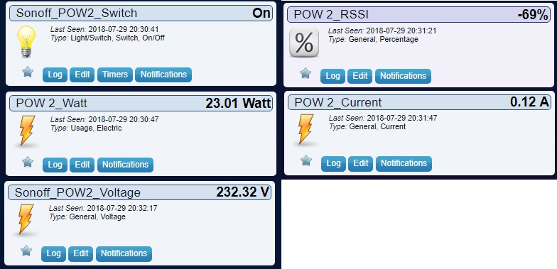

Btw ... this is how Domoticz handles right now the incoming data from the POW (R2)
Keep in mind i did not set any divider yet but its clear to see its not adding but just restarting the counter.

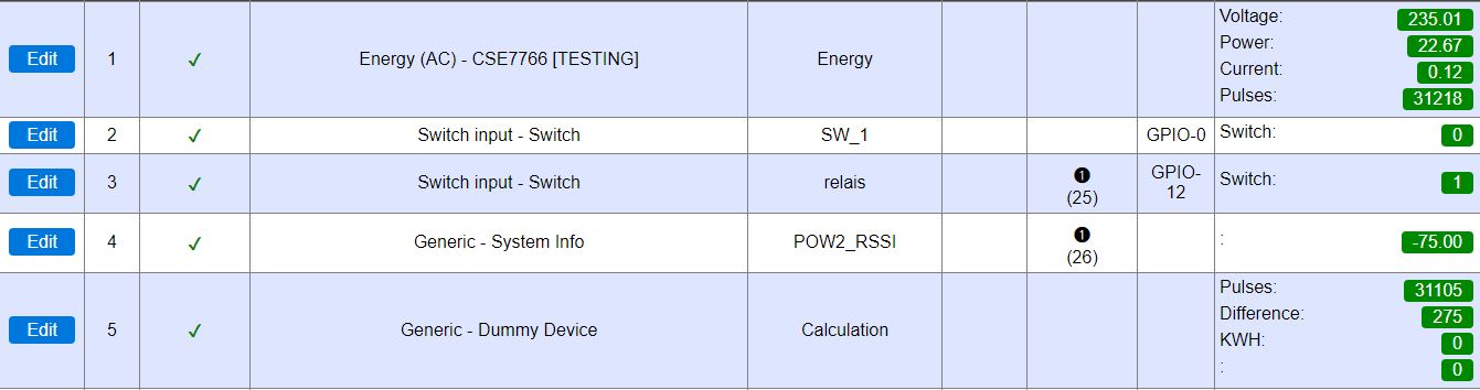

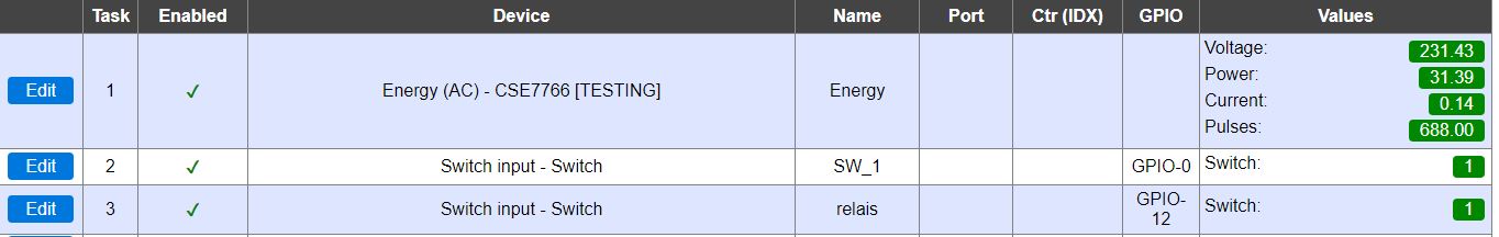

@Prutsium: Guess you were looking for the KwH right? Or different value? As you mentioned the pulses. I'll be sending the data every 30 sec of 1 minute we can do something with that or count the amount of pulses indeed over a time period and look at the difference.
Sonoff POW R2-vpc.JPG (87.36 KiB) Viewed 9975 times

sincze wrote: Sunday 29 July 2018 20:36 @Prutsium: Guess you were looking for the KwH right? Or different value? As you mentioned the pulses. I'll be sending the data every 30 sec of 1 minute we can do something with that or count the amount of pulses indeed over a time period and look at the difference.
Yupp the Total usage (pulses) as they are a rolling counter (goes to 65xxx and then back to 0) You must do a lot of tricks to get them stored.

Ok so we got the amount of pulses between measurements. I guess??
Sonoff POW R2-pulses.JPG (67.91 KiB) Viewed 9968 times

Yes but also did you handle the fact that the total pulses will jump to 0 when they reach 65xxx? So you must create a virtual Previous + New.
Yes I did, that was the tricky part right ??
Store the value of the pulses in new variable and then the magic starts.
It was described a few posts back on how to do it.
Now I need to figure out what we want to do with the pulses. :D

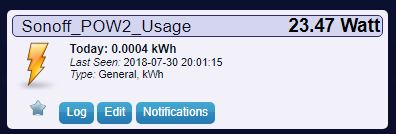

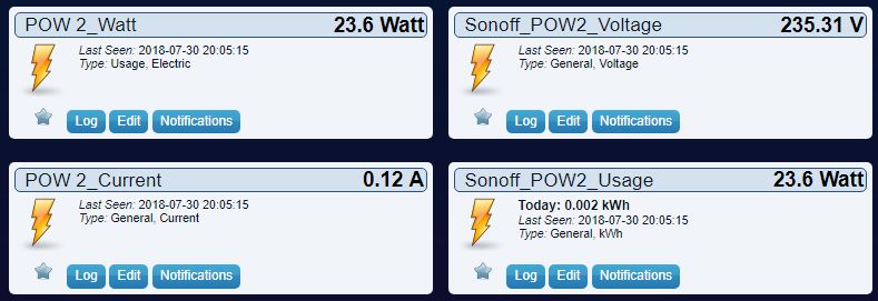

If you just create a virtual sensor Electric (Instant+Counter).
Open the sensor and select 'computed'.
https://www.domoticz.com/wiki/Domoticz_ ... counter.29 it can help to monitor the kwh.
1
1
Sonoff POW R2-kwh.JPG (19.36 KiB) Viewed 9894 times
In this case I just see no usage anymore for the pulse counting.
Any suggestions?
I now have:
2
2
Sonoff POW R2-kwh-final.JPG (50.57 KiB) Viewed 9894 times
tnx.
