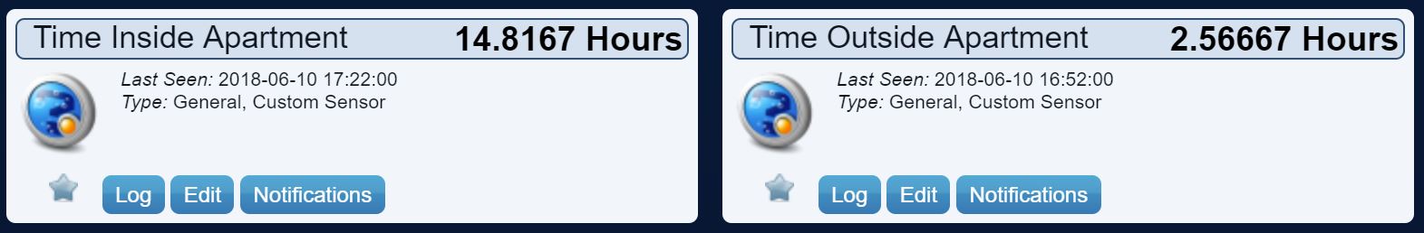

This is a couple of Lua scripts I wrote for tracking time spent inside and outside my apartment each day.
1) Create a couple of custom sensors and name the "Axis Label" "Hours".
2) Create two seperate Lua TIME scripts in Setup > More Options > Events
Edit below scripts as needed, in particular the method you use to determine if you are home or away from home (mine is called "Ben is Home").

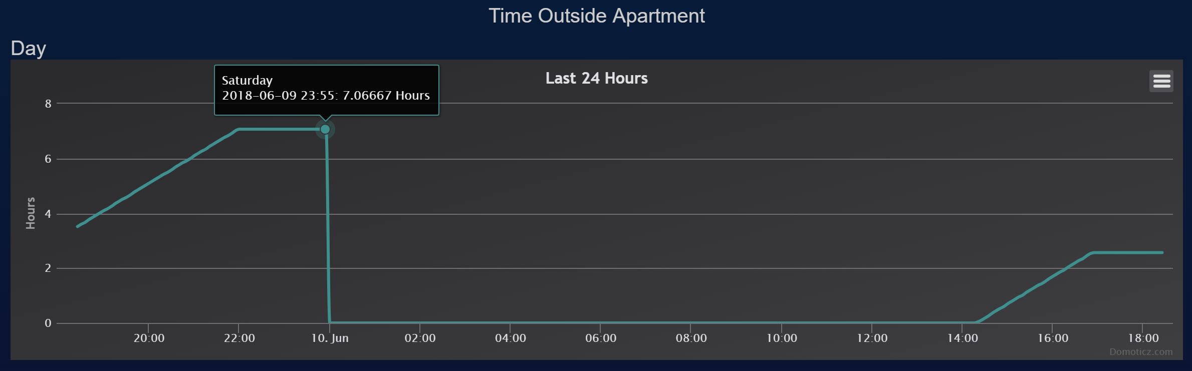

-- Reset hours 1 minute before mid-night (for charting reasons)

I've been running this for about a couple of months now and collected some interesting data. 8-)
