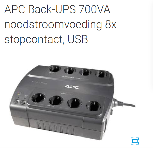

I don't know if such a device exist but for the protection of my Synology NAS, I use this UPS
This protects against power surges and will keep the power on my systems for about 30 minutes while disconnected from the grid and then gracefully stops my NAS.
The remaining free outlets are used to protect my PI's, Hue bridge and HomeWizard stuff. So in your case it could prevent the "flickering" of the power to your PI's
