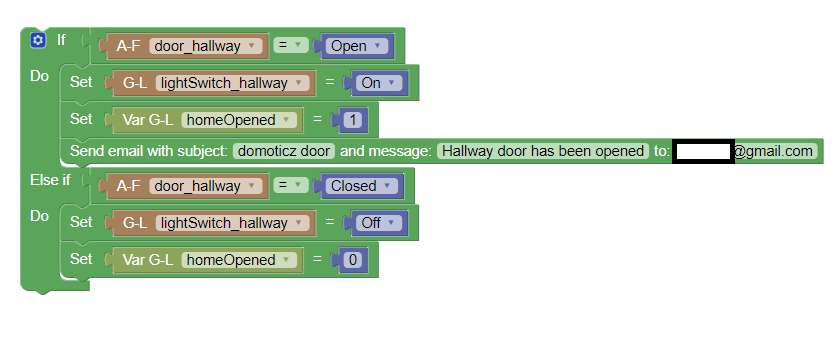

I want to have e-mail notification in responding to events. I try to configure e-mail (gmail) and I don't have any message. I don't have port forwarding (I can't have access to router). Is it related with this issue?

Does the Test message arrive?
Edit: Just tested with my own gmail account using SMTP (587), works just fine.

I don't port forward and get email notifications fine.
I set up a separate email account just for notification since they are free
My primary account requires confirmation so had trouble with that. Separate email is better anyway don't have to worry about email security

still, I don't have any message in my gmail account...
password, I put my password to my gmail account
and also it doesn't work

Just a simple question.
Did you configure for each switch/sensor, if you want to send a notification for that switch/sensor, the notification?

Not sure if it helps, but often you may need to dive into your Gmail SMTP relay settings, as often Google will block other services from using this, unless you specify it can be allowed.

The key seems to be app-passwords within Google. In your Google account go to Security and create a new app password (Name it for example: Domoticz for RP) and use the generated password in the password field in the email setup of Domoticz. Username should still be your gmail address of course.
For me this worked. I was able to sent test emails and email notifications again.
