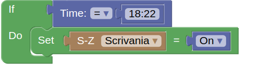

fabiorodo
Joined: Sunday 13 May 2018 11:53
Re: EventSystem: reset all events...
Post by fabiorodo »
thank you for your reply.
this is the blocky:
FireShot Capture 20 - CasaErreTi - http___192.168.178.44_8080_#_Events.png (14.45 KiB) Viewed 3634 times
the event is active and saved.
scrivania is a light switch but i also tried several others.

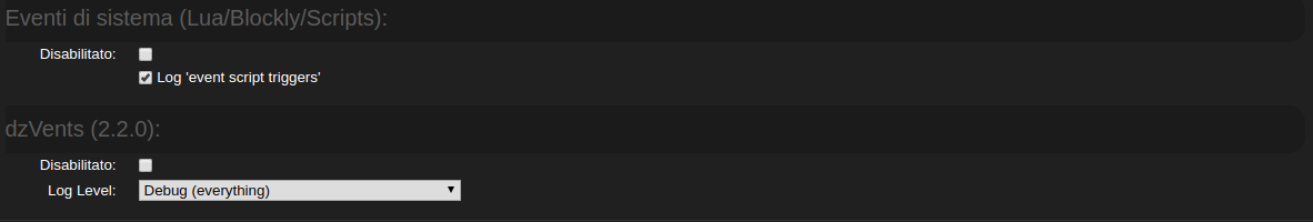

fabiorodo
Post by fabiorodo »
Hi to all,
this is what I have...
I found different pics in the forum.
but with both chrome and firefox in linux mint i get this.
FireShot Capture 24 - CasaErreTi - http___192.168.178.44_8080_#_Setup.png (23.69 KiB) Viewed 3605 times
thanks for support
f
SweetPants
Post by SweetPants »
Are you sure you are running V3.9426? Then dzVents should be V2.4.5. I think you still have a application cache problem. Please clear your browser and application cache first (both are different things)
fabiorodo
Post by fabiorodo »
Hi All,
thanks for your suggestions. I solved using Opera from mobile. even if I deleted the browser cache many times something was going wrong. events where disabled (in firefox and chrome the box was really confusing). right now I am trying to clean the app cache.
Thanks again
SweetPants
fabiorodo wrote: Sunday 27 May 2018 18:38 Hi All,
Thanks again
As said before you should clear your browser and application cache. The application cache is holding the old .js scripts hence the old data you see
