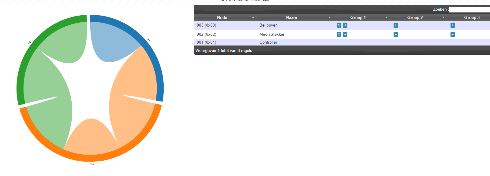

So I got a fibaro wall plug, is only has link with another wall plug which can reach the z-wave stick:
z wave
z wave
The second wall plug data is recedived by domoticz. But when I want to toggle the wall plug I get a timeout:
Domoticz reports a timeout.
I tried healing the network but this didn't work. What could I do to solve this?

Tried this, but also a total reset of controller and wallplugs. Put them into the same room (5cm apart) and re-added them. The first one always works without problems. The second on does not.
It look like the controller only can connect to 1 device, it never connected directly to both. So the topology always looks as above.

Swapped the Z-wave stick. Problem is a bit more related to one wallplug.
The 'bad' plug works normally but after switching it on/off via domotica I get a timeout:
2018-04-20 19:41:44.149 OpenZWave: Received timeout notification from HomeID: 3588394851, NodeID: 3 (0x03)
The 'good' plug is places upstairs and works normally (node 4). So the controller can communicate with the bad plug, node 3, and node 4 communicates with node 3 only (according the topology)
Node 4 does not get any timeouts.
Why do I get timeouts while the wallplug doe respond? Complete log when turning it on and off:
