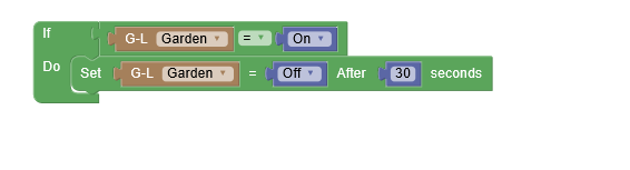

Hello
I have a Xiaomi Gateway which can function as a doorbell. Its levels are 10, 20, 30, 40. I also have a single button. I would like to set the devices so that when i would press the button it would stay on for as long as the doorbell sound would last. How can I achieve this? I am new to this.

i am also new to domoticz but will attempt to answer (my first post, Yaaay)
You should be able to create a rule in Blocky (under events), where you can set the switch to off with a delay after it is detected as on.
Something like this:
