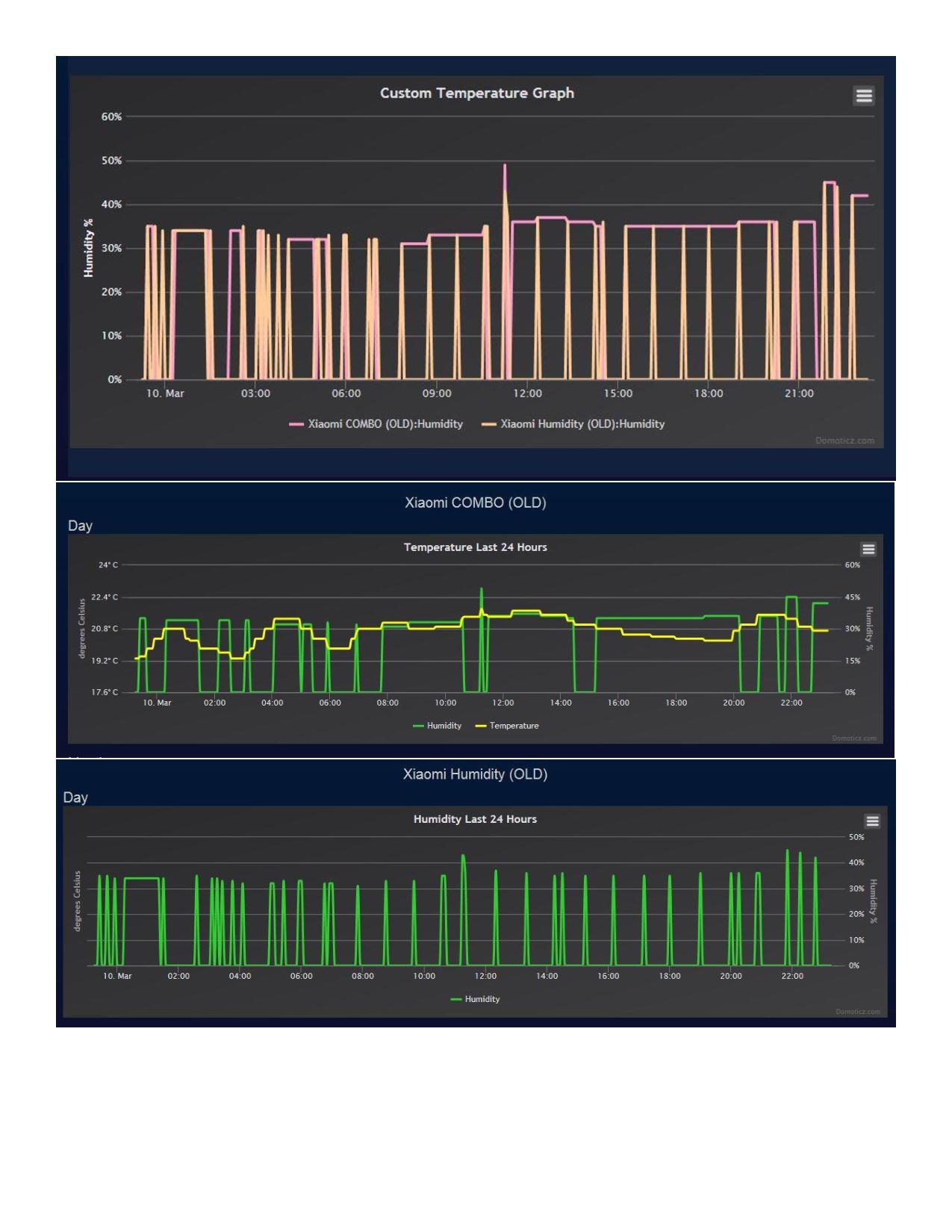

The Humidity sensor has usually value 0 and sometimes it is correct.
The Humidity value for Combo sensor is correct most of the time, but sometimes it is 0
See graphs below:
Xiaomi-page-001 (1).jpg (162.97 KiB) Viewed 1866 times
There are 4 possible cases:
case 1. Humidity sensor correct / Combo sensor correct
case 2. Humidity sensor ZERO / Combo sensor correct
case 3. Humidity sensor ZERO / Combo sensor ZERO
case 4. Humidity sensor correct / Combo sensor ZERO

After this event, the status of the devices is:
Humidity: correct value, Last seen: 21:47:58
Combo: correct value, Last seen: 21:47:58
Everything looks fine (case 1 described above)
Event type #2 - update of Humidity device to 0
2018-03-10 21:50:08.835 LUA: Xiaomi Humidity changed
Humidity: 0 (WRONG), Last seen: 21:50:08
Combo: correct value, Last seen: 21:47:58 (NO CHANGE)
(case 2 described above)
In the log, there is only my debug message from lua script.
This happens every 5 minutes and looks like a bug to me.
Humidity: 0 (WRONG), Last seen: 22:12:04
Combo: 0 (WRONG), Last seen: 22:12:04
(case 3 described above)
Today I wasn't able to reproduce case 4 - correct value for Humidity device and 0 value for Combo device.
