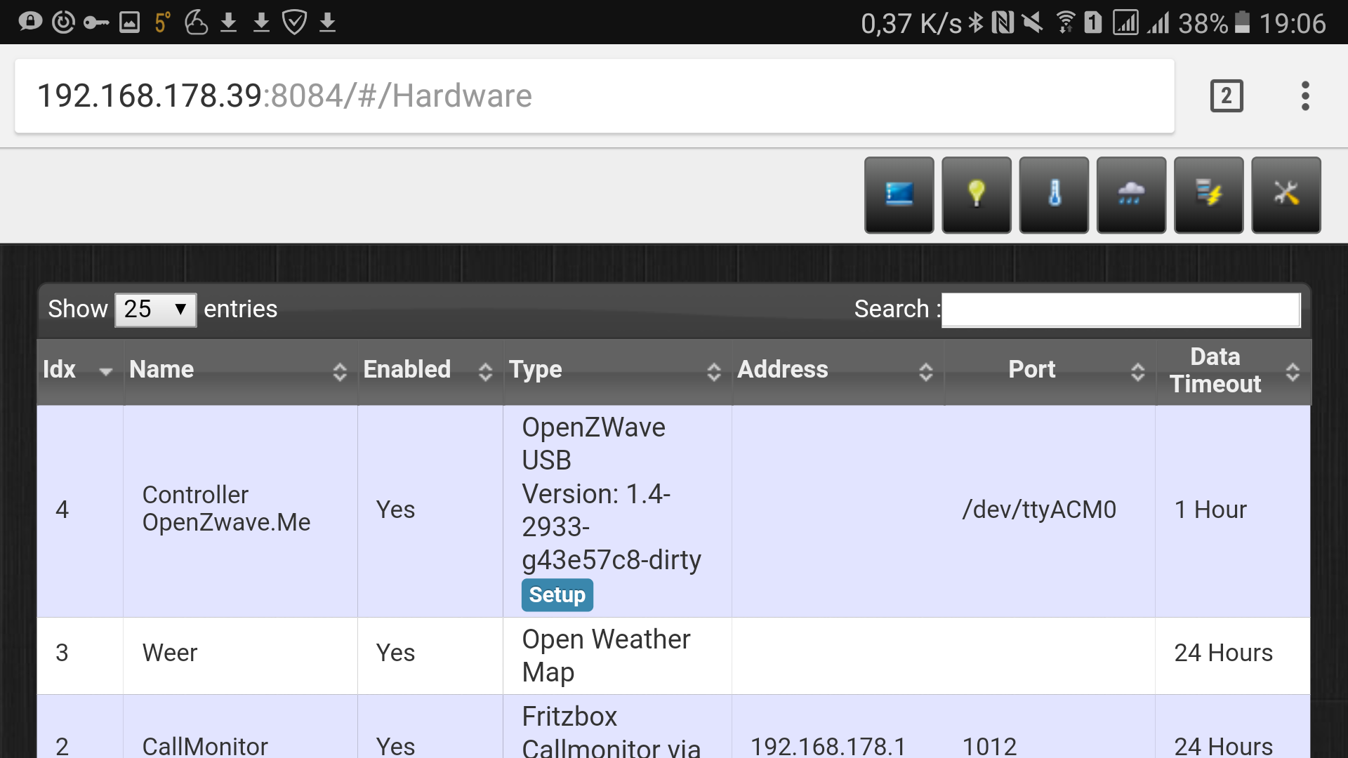

Without the controller you can't control the switch.
Here a picture of my added Zwave.me USB1 controller.
Zwave.me ctrlr usb
Zwave.me ctrlr usb
Re: USB Zwave Transceiver UZB1
Posted: Tuesday 20 March 2018 19:10
by berkens
See the port : /dev/ttyACM0 on my DS214.
After installing the controller you need to include new hardware via the "Setup" button on the row with the controller.

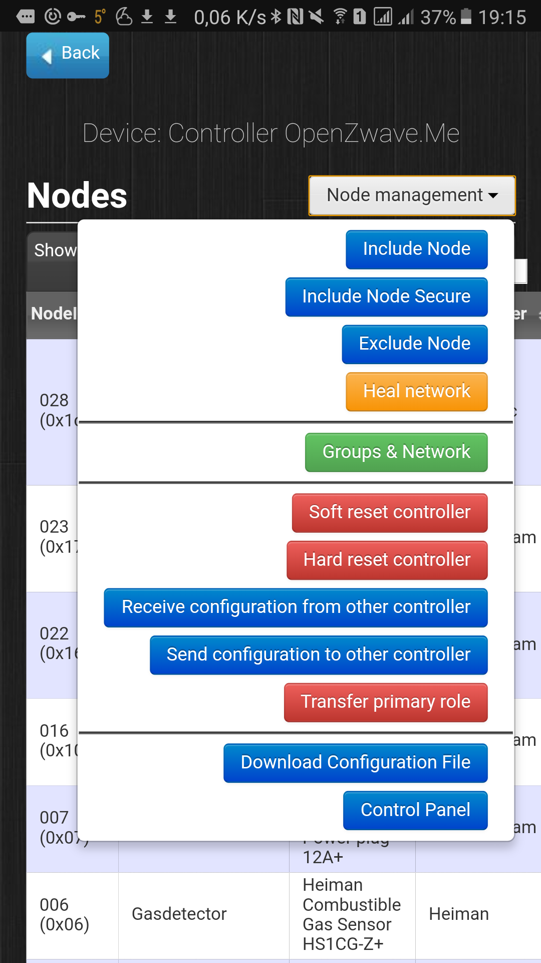

Then select the pulldown menu "Node management" and select "Include node".
Now start the include-node procedure on the device you want to include.
Include node
Include node
Hope this help.
