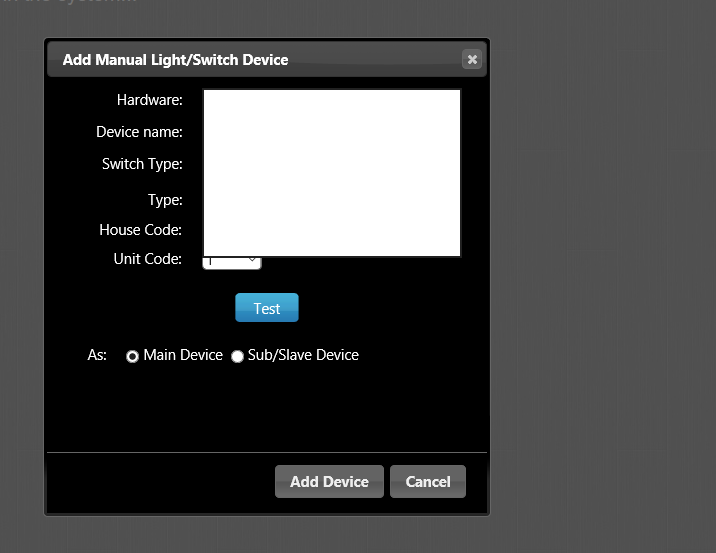

Hello @ all,
I have the problem that i could not find the Stick in the Hardware list.
Also i could not install a in wall mount relay and getting started.
Domoticz is installed on a Syno 712+
can anyone help me?
Update
The UZB Stick is Installed:
But i have still the Problem that the Switch will not be included. Auto include did not work and manually include dont work because i see no Hardware list. :-( whre is my mistake?
Next update:
Now i try to install on Windows. Same Problem: the stick ist included but the in wall mounted Switch will not be senn by DOMOTICZ.
manually Installation from the Switch is not working because ic get no List in the Hardware field. When i click on add i get the error message no Hardware device selected. How can i select Hardware when i do not see any Hardware to select?

Without the controller you can't control the switch.

See the port : /dev/ttyACM0 on my DS214.
After installing the controller you need to include new hardware via the "Setup" button on the row with the controller.

Then select the pulldown menu "Node management" and select "Include node".
Now start the include-node procedure on the device you want to include.
