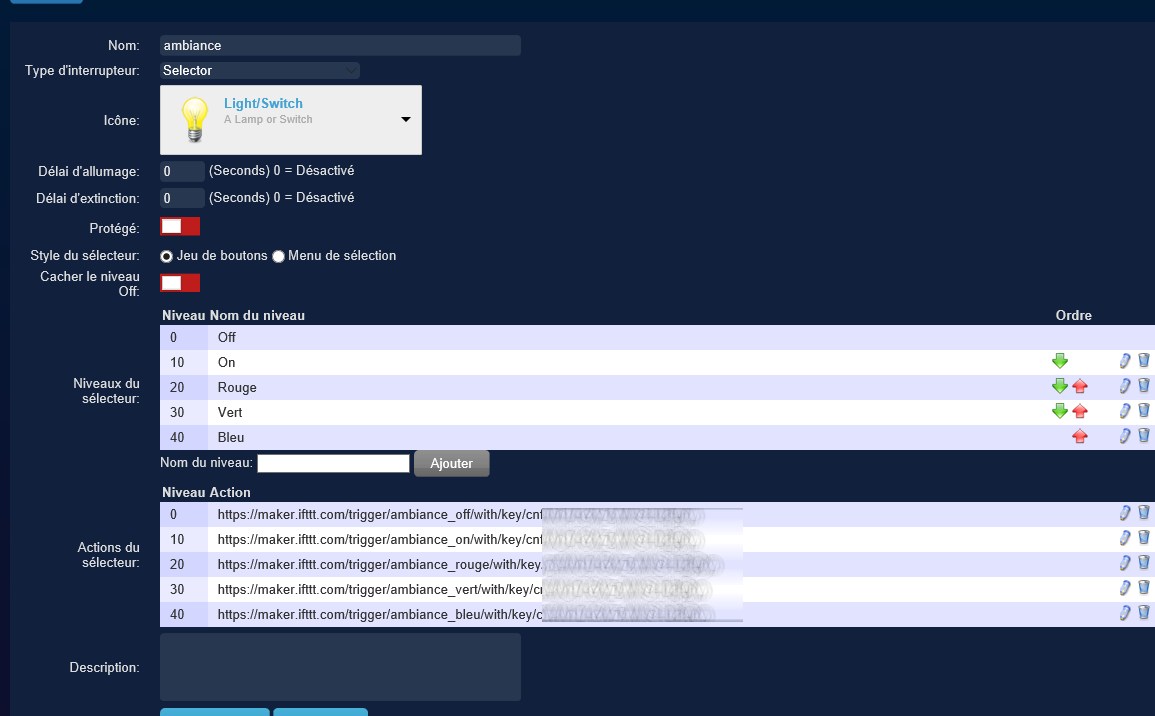

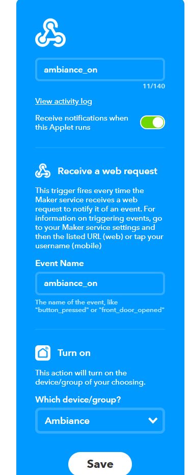

Re: [REQUEST] Plugin for Tuya
Post by fratton »
you can use ifttt to control from domoticz with webhook request same :
