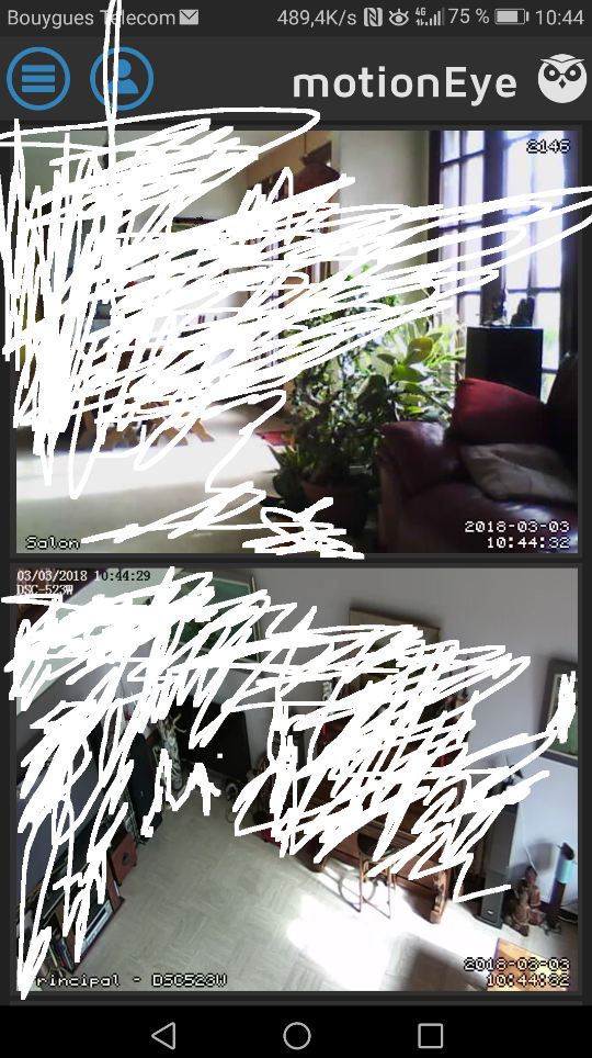

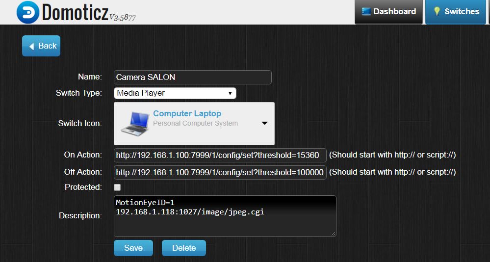

I've just finished setting up motionEye for camera management in addition to Domoticz. It's great...
- 100% web mode (without install of plugin / applet / dll) with traditional browser or smartphone, all cameras are displayed whatever the brand of the camera,
- motion detection feature integrated into the software (more configurable than the native functions embedded in the cameras) with alert emails sending or others stuff,
- and...activation / unactivation of this motionEye detection feature from Domoticz. When I activate my alarm appliance using the Domoticz SecurityPanel for example, my wired alarm is armed but ... also all the cameras, i.e. the Motion/MotionEye motion detection, which was before in pause mode, is activated. ** The trick (I use) is to use the motion HTTP API and to modify the threshold parameters of all my motion camera threads **.
In terms of resources required for motionEye, after many tests, I am about 3% CPU per camera and 200 Kbs for LAN/WAN bandwidth per camera. I use VGA resolution within motion/motionEye.
Web_MotionEye - Copie.JPG (367.81 KiB) Viewed 13575 times
Mobile_Screenshot_motionEye - Copie.JPG (134.57 KiB) Viewed 13575 times

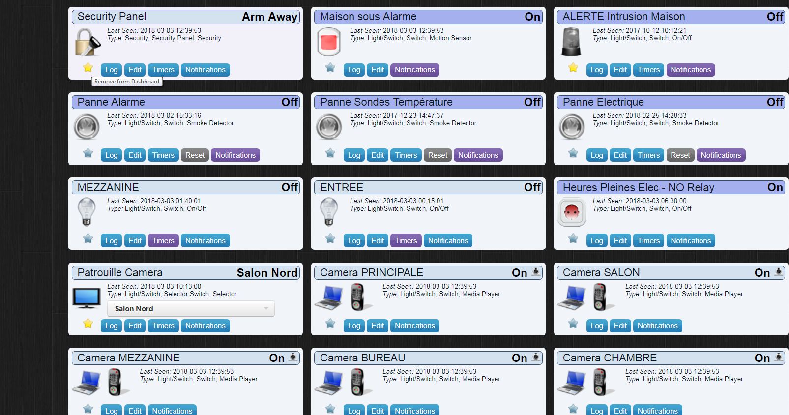

Using a script, all my motionEye cameras threads are also automatically activated or unactivated when I switch On/Off my alarm appliance using the security panel.
Detection Activated.JPG (255.49 KiB) Viewed 13565 times

Re: Domoticz able to activate motionEye motion detection
Post by Antori91 »
Yes, sure it works in a RPI...I did it in a RPY. My Domoticz server is a Synology but the server I use to manage the cameras (where I've installed motion/motionEye) is a Raspberry.
About how I did it, you have information about motion HTTP API here http://www.lavrsen.dk/foswiki/bin/view/ ... ionHttpAPI
To explain a little bit further, motionEye sits on motion. Motion is the core system and is able to receive requests using HTTP API. I assume that motionEye itself uses that HTTP API to manage motion. So I use this motion HTTP API to change on the fly some parameters which results in enabling or not the motion detection. To come back to my architecture, because I use two servers and so motion receives requests from a remote server, I have to change motion.conf. The parameter webcontrol_localhost must be changed from on (default) to off. But if you have only one server, I assume you don't have to take care about this. Last, notice that motion port (7999 in my installation - defined in motion.conf) is not motionEye port (usually 8765).

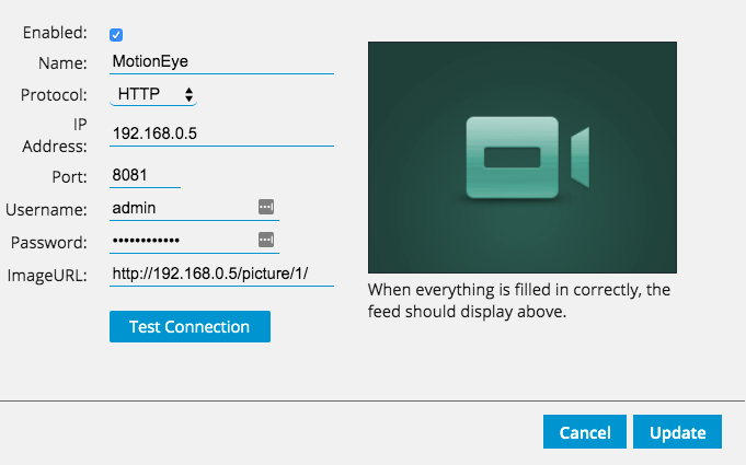

No matter what I try, I can't get MotionEye to show a camera feed in Domoticz :(
Screen Shot 2019-12-14 at 20.25.40.png (60.1 KiB) Viewed 7110 times
When I go directly to http://192.168.0.5/picture/1/current/?_ ... <signature deleted> I can see the feed.
Post by felix63 »
In the direct link you don't give a port number. But in domoticz you seem to refer to port 8081. If you change that port number 8081 to 80 what happens?
Post by EdwinK »
Same. Nothing changes :(
Now I think about it, it's indeed strange that Motioneye gives a streaming port at 8081, but it doesn't use it in the links to provide.

Hello EdwinK,
The parameters you entered in Domoticz are clearly false. For this Snapshot URL given by motionEye: http://192.168.0.5/picture/1/current/?_ ... ydede71809
I will try:
protocol: http
ip address: 192.168.0.5
port: 80
username: admin
password:
imageURL: /picture/1/current/?_username=#USERNAME&_signature=yyyyyyyyyyyyyyyyyydede71809
PS: about your last post, the streaming port is for streaming, not for snapshot. motionEye gives two different URLs for snapshot and streaming. Domoticz supports only snapshot mode.

EdwinK
Posts: 1820
Location: Rhoon
Post by EdwinK »
Thanks. Going to try this later.
Mm.. still not working :(
And fixed now. :)
