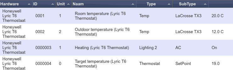

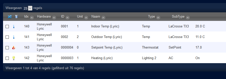

I don't know who, but somehow somebody implemented the Indoor/Outdoor Temp sensor / Temp Setpoint for the Lyric in the latest beta build!! I'm very gratefull for helping me with this. Thank you very much!!

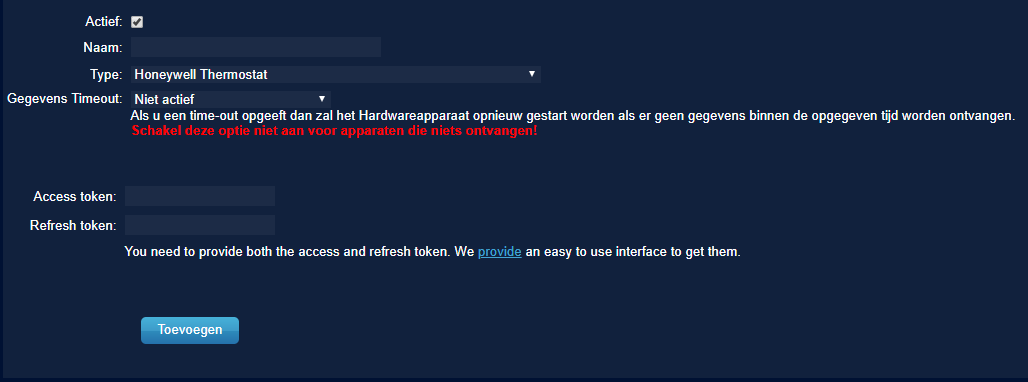

I chose the following hardware option:
To get both the tokens press the "provide" link and enter the credentials associated with your Honeywell account (same credentials as entered in the Honeywell Lyric App). If you copy / paste the tokens from the website and after that Add the device, 4 devices will be created for the hardware.

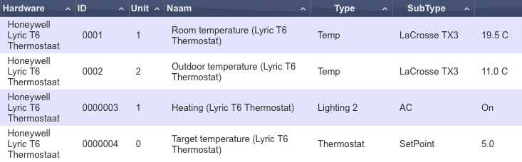

It works for me in the stable version and now I want to switch off the Lyric when the patio door is open and switch back on when its closed again.
Until lastweek I did that without any problem with a Homekit doorsensor but since I had to replace that sensor with a z-wave sensor I need to do that from Domoticz.
This can easily be done with a blocky, however, when my thermostat is switched on again it has a setpoint of 5 degrees instead of the scheduled setpoint.
I have to remove that 5 degree setpoint in the app on my phone to make it resume the scheduled setpoint again.
This happens from blockly but also when i switch off / on the "Heating switch" on the switches panel.
First I can see the 5 degree setpoint on my thermostat and on phone app and it does take a while before it shows in the setpoint in Domoticz.
Probably that has to do with the "Error getting thermostat data" I get sometimes.
2018-09-29 20:48:18.900 Status: User: Admin initiated a switch command (273/Heating (Lyric T6 Thermostat)/On)
2018-09-29 20:48:20.477 (Honeywell Lyric T6 Thermostaat) Lighting 2 (Heating (Lyric T6 Thermostat))
2018-09-29 20:48:20.483 (Honeywell Lyric T6 Thermostaat) Lighting 2 (Heating (Lyric T6 Thermostat))
2018-09-29 20:49:03.320 Honeywell: Storing received access & refresh token
2018-09-29 20:49:04.315 Error: Honeywell: Error getting thermostat data!
Schermafdruk 2018-09-29 20.47.53.png (46.58 KiB) Viewed 13548 times
Schermafdruk 2018-09-29 21.07.43.png (46.59 KiB) Viewed 13548 times
Anyone else seen this behavior?

Hmmm... When I turn the thermostat Heating On/Off the Setpoint remains the same, in my case 18 degrees.
EDIT: I'm wrong, here exactly the same: It changes my setpoint to 5 degrees!
