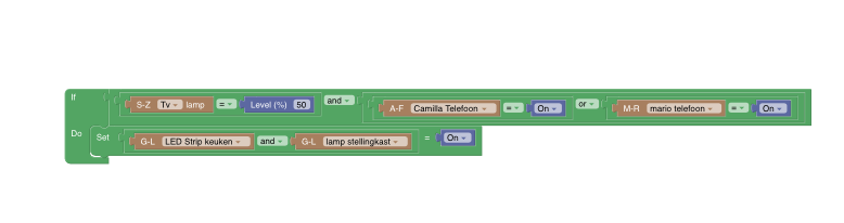

I just started with creating events in Domoticz, I think it is a easy one but for a noob like me it isn't.
the script won't work. the meaning of the script is when the "tv lamp" goes on (it is a hue) and we are home, this will be checked with the ping on our phone, the other lights goes on.
I hope you can help me out.
Regards, Mario
first blocky won't work

Re: first blocky won't work
Make it
(....) AND ( (Camilla Telefoon=ON) OR (Mario Telefoon = ON) )

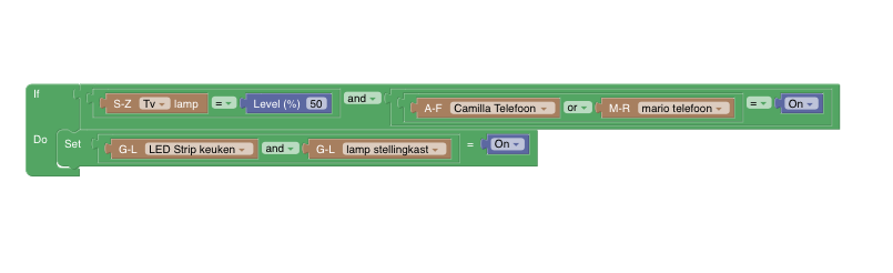

thanks for the quick response, you mean like this?
it isn't working yet do you know what is wrong?
thanks in advance
thanks in advance
Hi, try using a "Set" block for each switch:-
Set switch 1= On
Set switch 2= On
Set switch 1= On
Set switch 2= On
i have tried 2 set commands to, is it possible the hue's aren't working with a script?
Can you show your modified Blockly?carpaccio wrote:i have tried 2 set commands to, is it possible the hue's aren't working with a script?
