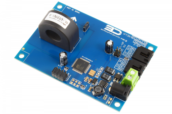

If you don't want to actually switch the dryer on/off and merely want to know the current consumption, you can use inductive current sensing with something like this which does not interrupt the circuit.
I have a 4-channel one in my fuseboard to measure the current going to the groups for washer, dryer, oven and dishwasher. Has an i2c interface that works directly with rpi. Manufacturer is ncd.io
- I2CCMAC110A_DLCT27C10_A_2-600x400.png (233.64 KiB) Viewed 538 times
