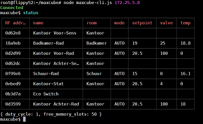

I am not a developer but found a some interesting links on a Homey forum.
I know there is another topic EQ3 max but for me it is very buggy and difficult to install.
Maybe this is news maxcube posted some java scripts on git hub to make it more easy to get the data from the Maxcube to intergrade with other software.
I am writing this hoping some Domoticz developer can do something with it. Or help me to find the right direction to implement it.
I think it would be very nice when it is added to Domoticz hardware. When so I surely want to be an tester for it!
Just take a look at below links maybe it is not so difficult anymore..
https://github.com/ivesdebruycker/maxcube
https://github.com/ivesdebruycker/maxcube-cli
https://github.com/ivesdebruycker/node- ... ib-maxcube
I managed to install the software and I am able to start the maxcube cli.
/Wim

I've been playing with node-red-contrib-maxcube. Seems to be working, except for reading the current temperature from the valves.
The code still needs (a lot of) clean up at the moment, and maybe there is to much feedback from Max! to Domoticz, but that's usefull for testing for now.
