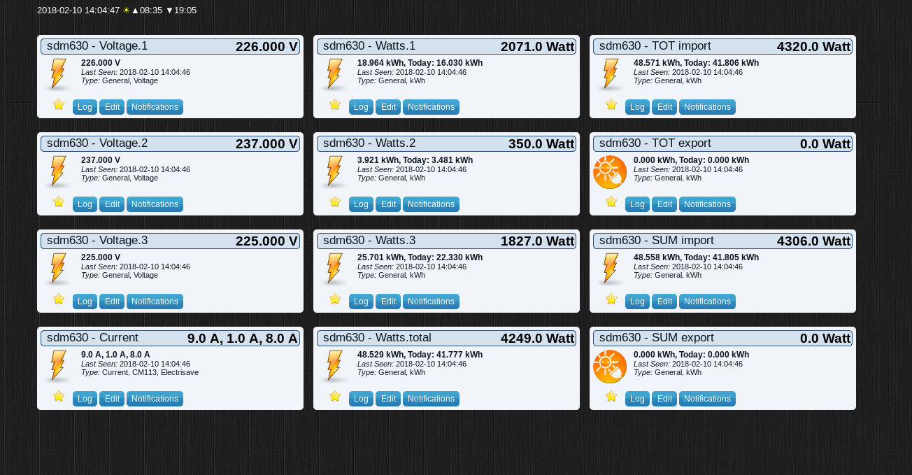

I'm coding an SDM630 smart meter plugin for energy usage and return for Domoticz at the moment. See attached screenshot.
It is working fine, except that i can only update Integer values instead of Floats.

I have 2 questions:
- I tried sending nValue=float(row[7]). That gives me a type error. How do I update a float value using a float ?
- How do I set the SubTypeName of the Current meter ? I used TypeName 'Current/Ampere'. It currently shows up as a 'CM113/ElectriSave', which I don't have.

aerno wrote: Saturday 10 February 2018 14:24 Devices[7].Update(nValue=int(float(row[7])), sValue=s)
nValue accepts integers only, you can't pass float with it. Usually, you pass float using sValue, but it is really up to the device type. You should try virtual devices and check which type is using nValue, which gets its value from sValue, and use the correct device type from your plugin.

Thanx. Currently still on integer values only. Floats would be nicer.

@aerno,
Have a look at https://github.com/dnpwwo/Domoticz-RAVE ... /plugin.py which writes to a couple of power consumption devices.
For historical reasons not all the Domoticz devices handle data the same way and the Python Framework has not attempted to fix it, it just exposes the Devices as they are.
I looked at these devices a long time ago and this code:
Devices[2].Update(nValue=0, sValue=sFloat.replace('.',''))
worked for me :o . From your extract below you might try something like:
Devices[7].Update(nValue=0, sValue=str(float(row[7])))
