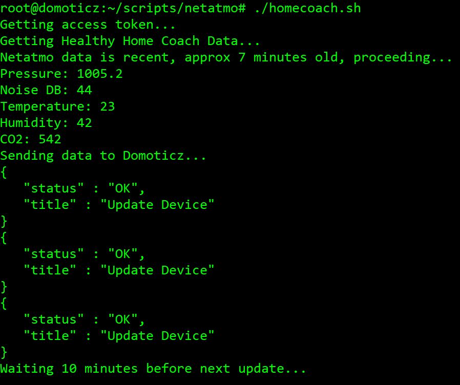

This script is an alternative to using the built in Domoticz Netatmo plugin, it gets data from the Netatmo API for the Healthy Home Coach and loads it into Domoticz via the JSON API.
I wrote this because I was having problems with the built in Netatmo Domoticz plugin, if you wish to use it here are the steps:
1) Go here and create an App, you can call it anything you like: https://dev.netatmo.com/myaccount/createanapp
2) Login to your Netatmo account and get the "Client ID" and "Client Secret" from your app.
3) Fill out the Domoticz and Healthy Home Coach Configuraiton sections of the script below
4) Create the Domoticz virtual sensor devices mentioned at the bottom of the script, don't forget to set their IDX numbers obtained from the Domoticz devices page
5) Install required packages using terminal: apt-get install jq bc screen

Example terminal output:
I start the main script using screen to run it in the background:
