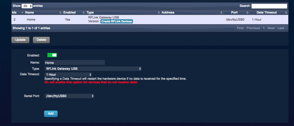

So i have RF link running on a arduino mega 2560 and tested it on a windows pc in domoticz and it's working great.
But having trouble getting it connected to my docker container in unraid.
So i can see the device in unraid:
lsusb
Bus 001 Device 006: ID 1a86:7523 QinHeng Electronics HL-340 USB-Serial adapter
I think the serial port has opened ok in unraid:
dmesg | grep tty
[    0.000000] console [tty0] enabled
I've used the following to pass rflink to the domoticz to container:
--device=/dev/bus/usb/001/006:/dev/ttyUSB0
Inside the container
docker exec -it domoticz dmesg | grep tty
I'm no wizard but i'm thinking that the port opened ok as i now get an adaptor i can select in the port drop down menu:
Screen Shot 2018-01-28 at 23.12.51.png (103.94 KiB) Viewed 1187 times
is there any way to test comms from inside domoticz to rflink? When trying to add a device nothing comes up like it did when i tested it on a windows computer.
