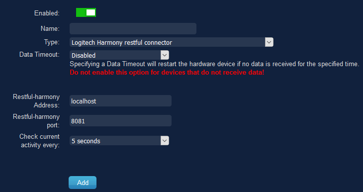

If i have this and my other python plugin (iDetect) installed and enabled, the hardware configuration screen gets messed up. Both are shown with the same hardware-type (but they aren't) and configuration parameters are not displayed (initial configuration went fine). Is this a know issue?
I will incude a screenshot of the malformed configuration page and the plugin itself. It might just work on your setup(?)

I pushed a fix today for an issue with the hardware configuration where some extraneous fields could be left on the page but doesn't sound exactly the same as your problem (but might be). Can you re-test in the next beta (make sure your browser cache refreshes) and if the problem is still there post the details.
If I had to guess I would check to make sure that the plugin 'key' field in the plugin XML definition is different between the two. The key needs to be unique. Its never shown so you can make it something pretty random.

Thanks for your input! The key was already unique, but after experimenting with all kinds of naming it turns out the module name was the culprit(!) If the string 'Harmony' is anywhere in de plugin name it will mess up the hardware configuration pages. This seems to be a Domoticz bug.
I have changed the plugin name to "Logitech H-rmony restful plugin" as a work around.

First thing i did was testing the Domoticz update that included your commit. Unfortunately it didn't solve this particular problem on my testserver.
Did you have a second python plugin installed? The problem only arose when the Harmony plugin was not the only (enabled) python plugin. In that case the 'hardware type' of the other plugin would also show as the 'hardware type' (name field in xml) of the Harmony plugin.
Even with another plugin installed you could still perform the initial configuration. After that you could no longer reach the existing configuration fields.
The new version of the plugin works just fine with the following xml in plugin.py:
<plugin key="restharmony" name="Logitech H-rmony restful plugin" author="ESCape" version="0.0.2">
If i only change H-rmony to Harmony the problem returns. Maybe you can confirm this with a second python plugin active(?)

I have rewritten the plugin to use the Domoticz connection framework instead of urllib. The heavy lifting is still done by restful harmony.
It seems to work quite well. Functionality remains the same. Installation is also the same as described in the top post. If you are already using the previous versions you can just replace the plugin.py file so you will even keep the same Domoticz devices.
For now i will post this new version as an alternative. If it proves to be as stable as the urllib approach i will replace the main version in the top post.
Here it is... the Harmony restful plugin using the Domoticz connection framework:
Harmony.zip
(186.78 KiB) Downloaded 124 times
Superseded!! See newer version below (or always check top post for newest version).

Can anyone, maybe a developer, shed some light on this?
Since i have moved to a new router (Asus ac86u) the connection to the Harmony Hub has become more stable. The plugin however is now locking up every few days. It becomes unresponsive and when i try to stop (disable) it, dozens of these messages appear in the log:
Error: (HUB) Callback event 'onHeartbeatCallback' (Python call 'onHeartbeat') discarded.
It will stop, but after re-enabling it nothing happens (log says it started, but still unresponsive). Restarting Domoticz does restore functionality.
This is the latest version of plugin.py (some changes in the error handling, to improve the way connection problems are handled. However, that didn't fix this issue)
