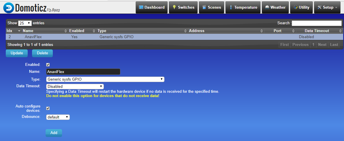

Added the Hardware, but there was no option for putting in a GPIO port.
Do i have to put the file plugin.py in its own directoriy under ./domoticz/plugins/??/plugin.py
See picture 2 for Domoticz log.
The attachment Knipsel1.PNG is no longer available

You selected the wrong hardware too. It should be "sysfs pins" or "sysfs switches" (I just changed the name of the plugin to make it more recognisable)
