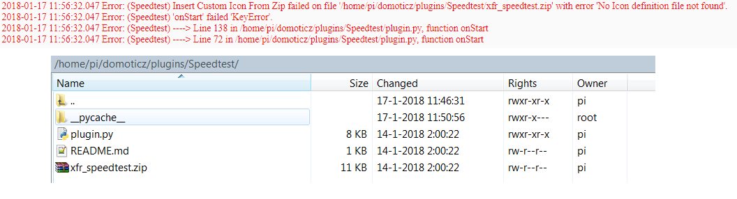

But i get an error from the script:
It looks like he cant find the custum icon in the zip file?

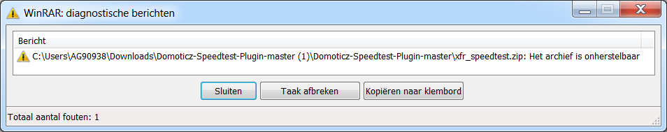

I also get an error when trying to unpack the zip file in windows:
Saids the archive is unrepairable
Maybe something is wrong with the zip, could you rezip and upload?

Same here, the ZIP file is corrupted!

My local version was correct. After a new upload, the image zip file was corrupt again :o . I did an upload again, now with 'Drag files here...' instead of 'Choose your files'. Now it seems to be correct! :)
Weird.

Still have this error
2018-01-17 20:08:38.842 Error: (Speedtest) 'onStart' failed 'KeyError'.
2018-01-17 20:08:38.842 Error: (Speedtest) ----> Line 138 in /home/pi/domoticz/plugins/SpeedTest/plugin.py, function onStart
2018-01-17 20:08:38.842 Error: (Speedtest) ----> Line 72 in /home/pi/domoticz/plugins/SpeedTest/plugin.py, function onStart
Running v3.8747

Grumpfff . During checking my other plugins, I uploaded the wrong one :oops: , as you probably have seen. Now the correct image zip is available.
