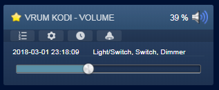

I would like to change the volume in domoticz
I have a tablet on the wall where I play the music ( headphone Jack)then I would go to the USB soundcard mic input, and then go to the line in from the radio
Can someone tell me how I can do that (script) I like the dimmer like picture

you can control the playback volume of kodi(media player) from domoticz. could that be a part of the solution for you?
