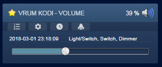

I would like to change the volume in domoticz

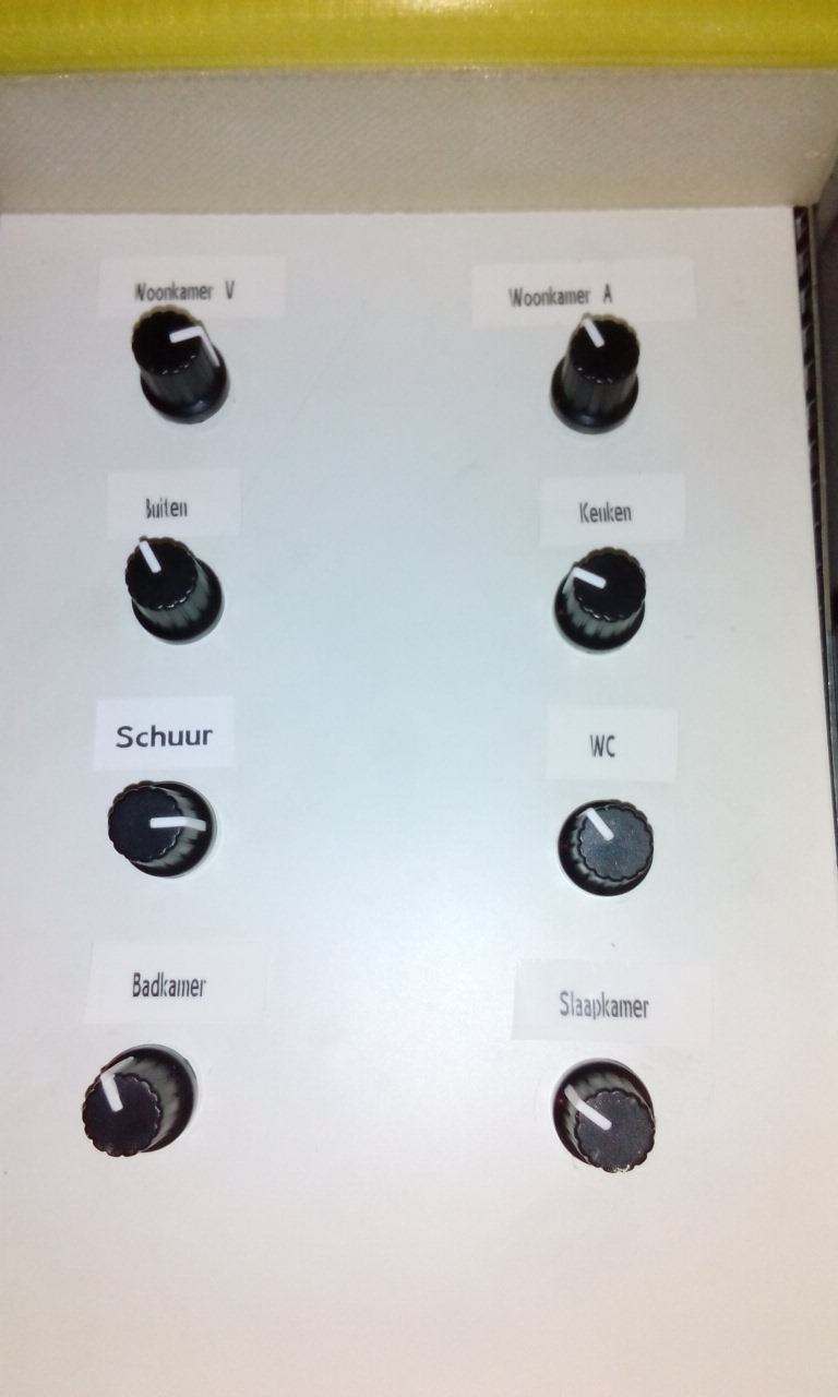

I have a tablet on the wall where I play the music ( headphone Jack)then I would go to the USB soundcard mic input, and then go to the line in from the radio
Can someone tell me how I can do that (script) I like the dimmer like picture
I have speakers in the hole house i can set them on and off with Domoticz
But i like to change the volume in Domoticz
