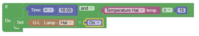

I'm new to domoticz so don't blame me if i'm wrong..
But couldnt you just use blockly like attached?
- Knipsel.JPG (21.51 KiB) Viewed 739 times

Thank you for your suggestions.
I forget to mention the first solution you have proposed.
So there is not easier solution (i find these solutions are not quick to implement compared to the timers but i understand the limitations).
Once again thank you for these suggestions.
