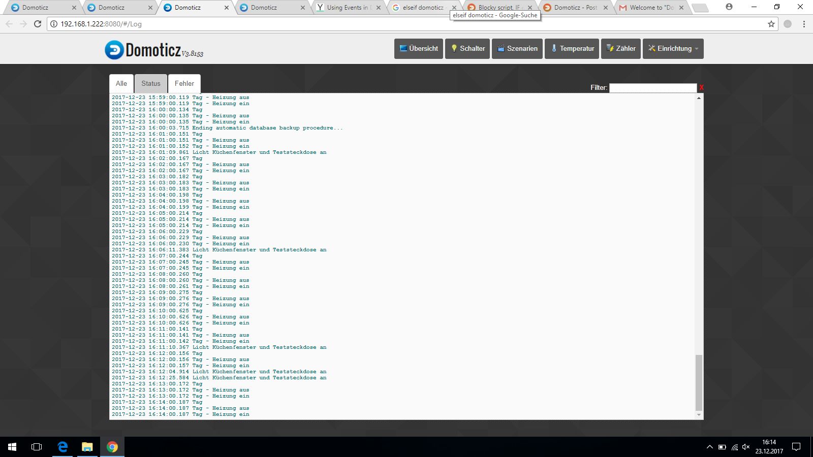

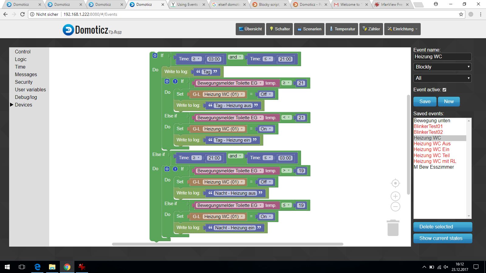

Questoin here: why do BOTH if's start up?
It shutrun between 03:00 and 21:00 - and it does.
But the following if's go both active, even if the temperauter is above 21°. And I don't get it why...
Please help!

Don't believe that Nested If's are supported in blockly, so you better code this in LUA/dzVents.

This happends because blockly can not trigger An event that is passed the 00:00.
You have create one more event. 00:00 < 03:00 the other one you have to change to 21:00 < 00:00.
And the if do ( with the blue dot ) is the master and can not be put in a if do ( with the blue dot ) You have to rearange that. An if do ( without the blue dot ) also.
