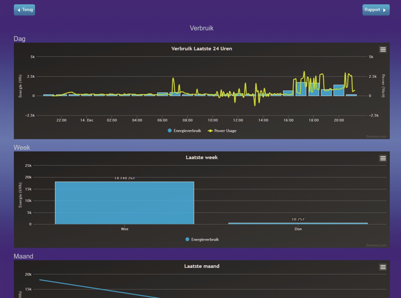

I've made the script for uploading my electricity tot pvoutput.
I've onli made the calculatin part.

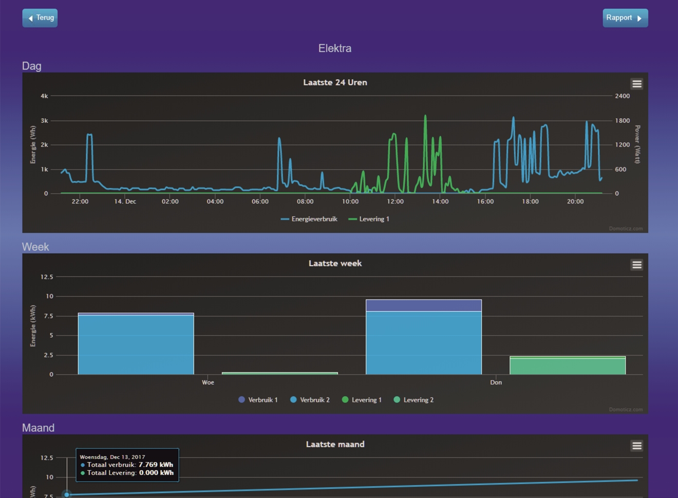

What i don't understand is the difference between the graph from my P1 smart meter en the calculation.
This is my script:

And this are the graphs:
Graph P1 smart meter and calculation added as files.
The graphs are still different while as my opinion they must equal
Can somebody explain me what's going wrong?
