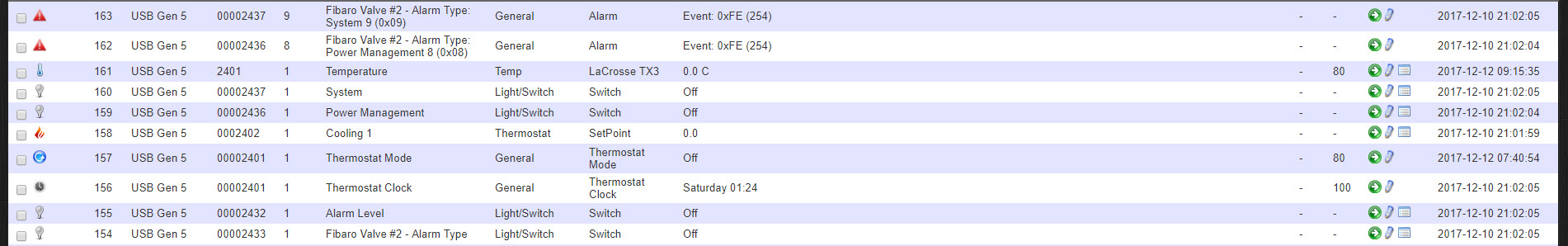

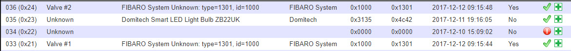

I am running domoticz (Version 3.8153) on a rasperry pi 3 with an Aeotec ZW090 Z-Stick Gen5 EU (OpenZWave USB Version: 1.4-2501-g5af6780-dirty).
I bought 2 new Fibaro radiator valves (https://www.fibaro.com/en/products/the-heat-controller/). Their "code" is FGT-001 (https://manuals.fibaro.com/content/manu ... T-v1.0.pdf).
This is what I see from the hardware
and device pages in domoticz:
How do I make it work? Has anyone worked it out yet? I checked the openzwave github page https://github.com/OpenZWave/open-zwave ... fig/fibaro but the config is not there. Is there any guide I can read to create an xml for this new device?
Thanks,
L.

It's still not recognized properly. I have added fgt001.xml and manufacture_specyfic.xml on the right places.
