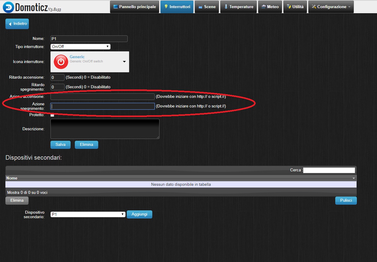

Ok i know this possibility but i'm not able to configure that...i have done in this way
IN DOMOTICZ
In Hadware i have set this:
but i don't know how to set the actions for power on and power off (this is the device with idx 1)

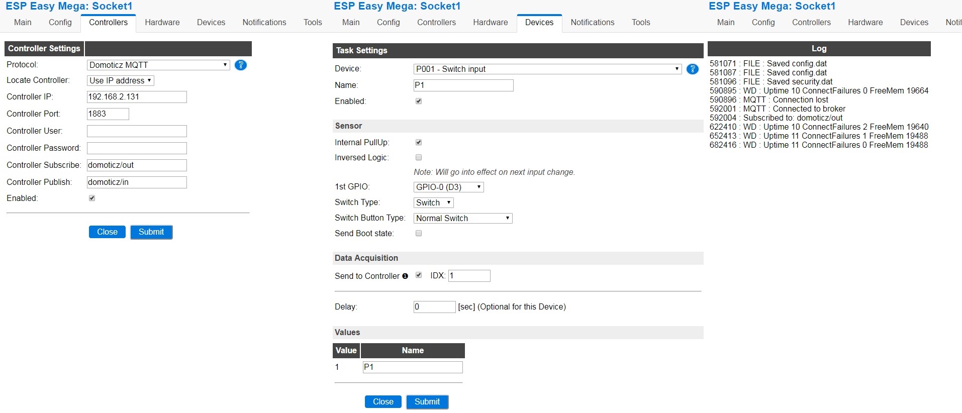

IN ESP:
i have this configuration, but the log (last picture) give me that error
