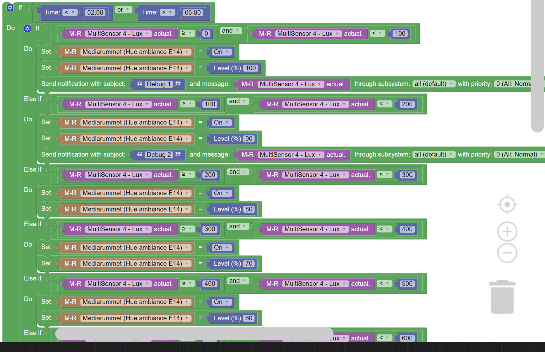

I have the following Blockly "code":
I've had problems getting it to work properly so I added a few debug messages to see which triggers that worked. Turns out that ALL of them trigger, when the Lux value is 0.
Is something broken or have I missed something?

Unfortunately nested if's do not work and with "else if" the conditions must be set so that all of them mutually exclude each other, otherwise all matching condition are executed even if a prior condition matches. See e.g. http://www.domoticz.com/forum/viewtopic ... fs#p128152
http://www.domoticz.com/forum/viewtopic ... fs#p151162

Thanks, that explains it!
