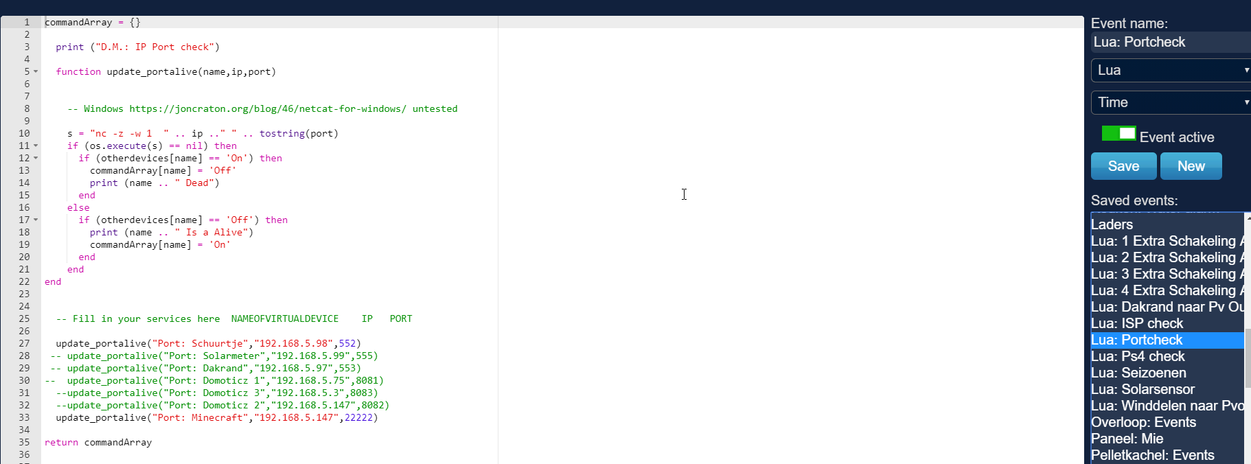

Dear al i did use a external lua script [ in map scripts...]
Now i did setup my new Domoticz hardware...
And try to make the script working in the internal lua option..
Do have:
Only not working anymore..
Perhaps someone see where a thing is going wrong?
Thanks for the help

Code:
  --print ("D.M.: IP Port check")
  function update_portalive(name,ip,port)
    -- Windows https://joncraton.org/blog/46/netcat-for-windows/ untested
    s = "nc -z -w 1  " .. ip .." " .. tostring(port)
    if (os.execute(s) == nil) then
      if (otherdevices[name] == 'On') then
        commandArray[name] = 'Off'
        print (name .. " Dead")
      if (otherdevices[name] == 'Off') then
        print (name .. " Is a Alive")
        commandArray[name] = 'On'
  -- Fill in your services here  NAMEOFVIRTUALDEVICE    IP   PORT
  update_portalive("Port: Schuurtje","192.168.5.98",552)
  update_portalive("Port: Solarmeter","192.168.5.99",555)
 update_portalive("Port: Dakrand","192.168.5.97",553)
  update_portalive("Port: Domoticz 1","192.168.5.75",8081)
  update_portalive("Port: Domoticz 3","192.168.5.3",8083)
  update_portalive("Port: Domoticz 2","192.168.5.147",8082)
  update_portalive("Port: Minecraft","192.168.5.147",22222)
return commandArray

So what is shown in the domoticz log file? it should show at least the text: D.M.: IP Port check

jvdz wrote: Wednesday 22 November 2017 21:05 So what is shown in the domoticz log file? it should show at least the text: D.M.: IP Port check
Yep there is:
2017-11-22 21:10:00.074 LUA: D.M.: IP Port check
Only no switching devices

Ok, so do as emme stated: run the command from the command prompt (shell) on the domoticz server to see what the result is.

when i run from putty:
root@DietPi:/home/domoticz/scripts/lua# ./script_time_portcheck.lua
./script_time_portcheck.lua: regel 1: commandArray: opdracht niet gevonden
./script_time_portcheck.lua: regel 3: syntaxfout nabij onverwacht symbool '"D.M.: IP Port check"'
./script_time_portcheck.lua: regel 3: `  print ("D.M.: IP Port check")'
So thanks for all te support...

You can't run the script from the command prompt as the eventsystem tables are missing when not shelled from the eventsystem.
Just add some more debug print() statements in the script in an effort to debug the whole script.
what does this script return in the logfile?:
function update_portalive(name, ip, port)
    print("debug:"..s)
        print("debug:  nil returned.  status of "..name.."="otherdevices[name])
            print(name .. " Dead")
        print("debug: Not nil returned.  status of "..name.."="otherdevices[name])
            print(name .. " Is a Alive")
update_portalive("Port: Schuurtje", "192.168.5.98", 552)
update_portalive("Port: Solarmeter", "192.168.5.99", 555)
update_portalive("Port: Dakrand", "192.168.5.97", 553)
update_portalive("Port: Domoticz 1", "192.168.5.75", 8081)
update_portalive("Port: Domoticz 3", "192.168.5.3", 8083)
update_portalive("Port: Domoticz 2", "192.168.5.147", 8082)
update_portalive("Port: Minecraft", "192.168.5.147", 22222)
return commandArray
Jos

2017-11-23 23:57:00.171 LUA: D.M.: IP Port check

That isn't possible with the script I posted as that line is commented out on line 3!
Do you have multiple version of the script or double check the update worked.

Now this is the update:
2017-11-24 19:52:00.648 Error: EventSystem: in Port test: [string "commandArray = {} ..."]:12: ')' expected near 'otherdevices'

Understand as I made a typo in the print() debug lines.
This script is tested and working for me on my test domoticz setup:
print ("debug: D.M.: IP Port check")
    print("debug:"..s)
        print("debug:  nil returned.  status of "..name.."="..otherdevices[name])
        print("debug: Not nil returned.  status of "..name.."="..otherdevices[name])
--update_portalive("Port: Solarmeter", "192.168.5.99", 555)
--update_portalive("Port: Dakrand", "192.168.5.97", 553)
--update_portalive("Port: Domoticz 1", "192.168.5.75", 8081)
--update_portalive("Port: Domoticz 3", "192.168.5.3", 8083)
--update_portalive("Port: Domoticz 2", "192.168.5.147", 8082)
--update_portalive("Port: Minecraft", "192.168.5.147", 22222)
return commandArray
Hope this will work for you too.
