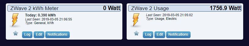

Re: Fibaro Wall plug inconsistant values
Posted: Tuesday 05 March 2019 21:12
by frustreerMeneer
I'm experiencing the same problem.
Did you find a solution?
