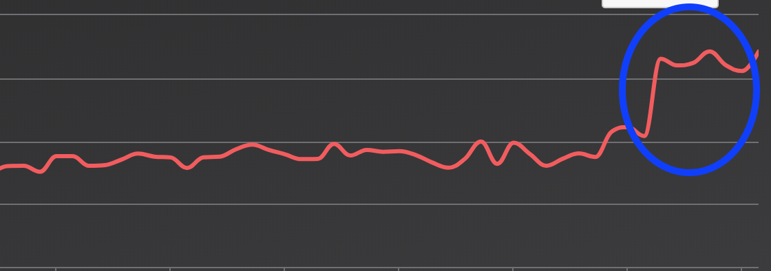

I recently upgraded my Raspberry Pi running Domoticz from version 2 to version 3 an wanted to update the OS at the same time to a more recent version. The update / migration went pretty smoothly and Domoticz seems clearly more responsive and e.g. loading the web GUI screens is now clearly faster.
However, I was wondering about the CPU usage as it has on average about doubled and the setup should be exactly the same except for the changed OS (Wheezy -> Stretch) and RPi platform (2 -> 3). I would have expected the opposite, but how should it be in the real life, is there some explanation to this? Are there some general RPi setup tricks I might have applied to the original installation of Domoticz (was done via the image) that I could now try to replicate to the new RPi3? Well, I think the CPU usage is still on very acceptable level and I have noticeable improvements in performance so this is not in any way a key issue for me to solve, it is more on the lines "would be nice to know the reason"...:)
The time of update is pretty clear on the screenshots. Average now is 3,1-3,4% and it was 1,5-1,7% so it has quite accurately doubled:

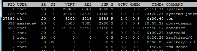

Thanks for the reference stats. As mentioned it is a fresh install based on minimal Stretch image. CPU was at "normal" level before migrating the old database and scripts. I tried disabling the event system but that did not seem to have an effect on the CPU usage. Do you or anyone else know what those systemd, systemd-journal and dbus-daemon are doing? It seems they add 2-3% easily but of course that is just a snapshot and might not be giving a realistic view of the situation.

Yes, running latest beta. Will try to check what is going on there with the systemd, I have a hunch it might be related to Mosquitto as I had all kinds of troubles in installing it...

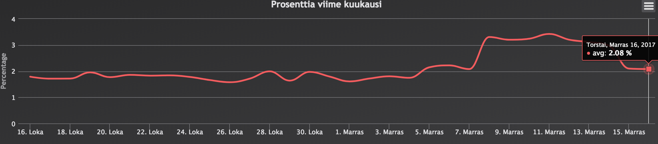

After removing mosquitto from systemctl things are (at least close) back to normal. The CPU usage is now pretty much on the same level as with RPi2, but I guess there shouldn't be any kind of big effect in any case. Probably there is still something (newer OS, newer Domoticz version, newer versions of other software etc.) on the new installation that hogs a bit more of the CPU than in the legacy installation, but so be it...:)
